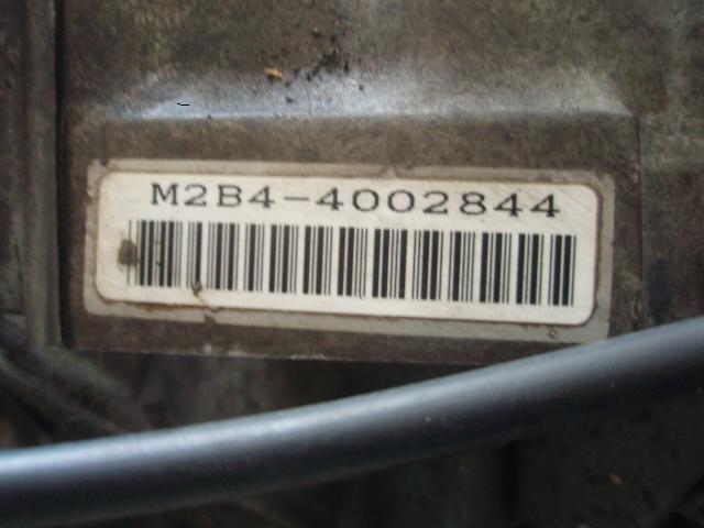

anyone here can help me o know how to read this honda gearbox code.........thanks in advance

M2B4 – JDM H22A tranny LSD Equipped
M2B4 is the Code, the rest is the serial number.. is that wat ur asking??

yes............n thanks............btw how to read that M2B4....what i means is M=?, 2=?, B=? and 4=?.......:hmmmm:....thanks very much
its just a numbering/coding system

M2B4 is LSD equipped, M2A4 non-LSD, prelude, and no, the M is not for manual, since the autobox is MP0A and MP1A.
Honda gearbox codes arent like the engine codes.
The F/H series spans 3 gearbox codes, the M, P and T.

thanks bro....................but still abit blur ...abt this..can explain more details..and how u know is from prelude not from accord????:hmmmm::hmmmm:
if its from prelude what gen? And btw only prelude Type-S equipped with LSD .....isit???:listen::listen:

the BB1/Bb4 VTEC came with either a manual M2B4/M2A4 or an auto MP1A
yes, the type S is equipped with an LSD, and some even had ATTS

do u mean that the gearbox is from BB4 M2B4 with LSD? if yes.........does the gear ratio n the LSD inside M2B4 same with prelude type-S o euro R?:hmmmm:
and how abt the final drive..........isit same o diff?:confused:

different
the T2W4 from the EuroR has closer stacked ratioes, very similar to the BB6 type S IIRC. correct me if im wrong.
The final drive is also shorter, but not by much.
there's a breakdown of the ratioes floating somewhere on the net.

ok ........isit ok to have and put this M2B4 gearbox in my h22a.........or find for T2W4 or prelude type-S gearbox?
how much is the FD in M2B4.....4.?

it IS the gearbox for the H22a. cheaper and much more common (not THAT common, though) than the EUro-R/Type-S gearbox.

M2B4 - 3.307 - 1.950 - 1.360 - 1.034 - 0.787 - 4.266 LSD
T2W4 - 3.285 - 2.090 - 1.481 - 1.071 - 0.812 - 4.266 LSD
M2Y4 - 3.285 - 1.956 - 1.344 - 1.034 - 0.812 - 4.266 (Prelude)
couldnt find the ratioes for the U2Q7 Accord Type R (UK)
If money is no object, then mate an integra/civic tranny to your H22a, and you get the H2B hybrid.
H/F series motor with a B-series tranny. A custom adapter plate is needed, though.

M2A4 - 3.307 - 1.950 - 1.160 - 1.034 - 0.787 - 4.266 w/LSD
looks here between m2a4 n m2b4 are no diff at all except the 3rd gear ratio......
..........whats is the difff when come to cruising.........which 1 is better???:confused::confused:
you cruise in top gear, not in 3rd, so wont be any difference.
