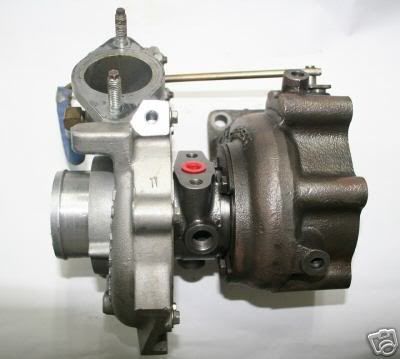

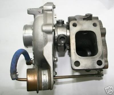

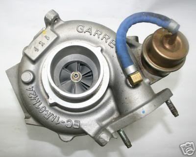

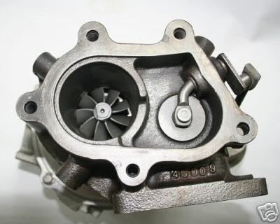

hi, anyone tried this turbo before or heard anything about it ?
anyway, i just bought this item online, anyone know how to see whether it is a real GT2835 ? below are the specs and pics.
Specs are listed by seller :
Compressor = A/R 61
Turbine = A/R 47
Compressor wheel: 42 / 59.4 mm (inducer / exducer)
Turbine wheel : 42.4 / 49.4mm (Exducer / Inducer)
Basically i dont really understand the specs? anyone can elaborate clearly for me ? really need the help and thanks ! and btw, how much HP can it generate ?
Is garrett officially have GT2835?.. I'm not sure
But HKS yes... its a hybrid Garrett GT28r Turbine wheel/housing and Garrett GT35r 71mm Compressor wheel. Rated ~ 380PS, check HKS website to confirm this.
The closest refference from Garrett website is the Garrett GT2871r which using also 71mm compressor wheel and rated ~ 400HP and many claim this also known as Garrett GT2835!
This "2835" now is too confusing and thats why you can see many variant spec specially at e-bay... coz many are china garrett knock-off.
Your spec seem to be similar with Garrett GT2560R aka GT28R or aka HKS GT2510 which rated ~ 300PS... Its a small turbo for your K20 project laa bro.. but with a killer transient response though!
u can check at www.turbobygarrett.com
all turbo can fix on ur car,but make sure to calculate the right boost bar and ur cc to match with the compressor map to get hi efficiency for the turbine u used.
there is garret 2835 is same as hks but is diff spec n material
If you have a change to view the compressor map of this "claim" garrett gt2835, you will see it have a identical map of Garrett GT2876r from garrett site... No offence, for me this 2835 is unmatched turbo... better go straight GT30R... :)
GT2835 exists on both HKS and Garrett platforms.
Garrett uses the 700382-series.
As for your turbo, it looks more like a custom matched turbo, the CH looks similar to the Mazda / Subaru style and Turbine housing is unknown. Do try and verify if it's genuine ball bearing.
