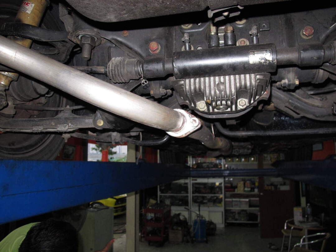

my i know what subframe of this ? its come with HICAS . R32,R33 or S15?

It`s running fluid HICAS definitely not R33 or S15..... it`s BNR32 subframe.What chassis is that?
Hahaha ok2 should this picture from HR32 GTS.... Feez show us the differences of R32 GTS and R32 GTR SUBFRAME~
hmm camne i nak take pic..bnr32 i got but not GTS one..hehe..

gtr32 subframe..you can see lot of diffrents..
GTS subframe
http://www.uqac.ca/~riceazar/misc/hicas/hicas_lockbar.jpg
and kalau you nak tgk r32 subframe is gtr or not, just tengok dekat rear absober dia..knuckle gtr should be like attached picture not like gts (guna round bushing)so tgk kat 260 ni punya absober pun dah nampak..all gtrs using knuckle type rear absober..
And mainly, GT-R subframes (for rears) normally uses hook type to screw on the coilovers
http://img403.imageshack.us/img403/2904/dsc03647j.jpg
While GT-S's are normally bush types.
http://japaneseperformancecentre.com.au/site2/cache/com_zoo/images/coilovers_GREDDY_R32_30321a3e5181b1e06398da5c480b7a29.jpg
So if R32 GTR subframe can be use on 260 or not? :)

Most likely yes, they're quite alot of old 240z's or olden fairladies in the US that provide kits for the conversion namely to fit the IRS and R200 diff.

From pic can tell it's a R32 subframe. Whether if it's BNR or HR, can't really tell. My R32 is running GTS subframe with GTR knuckles. Hehehehe.
thanks all expert opinion. one more question. the HICAS is disable. if use like that, dangerous? or need to lock it??

well, if u disable the hicas, there will be a free play of steering angle bu not muich but it will still effect the rear behavior. then again depends how u disable ur hicas. u can weld ur hicas rod, put spacers, replace the rack, change the whole sub frame, etc..
