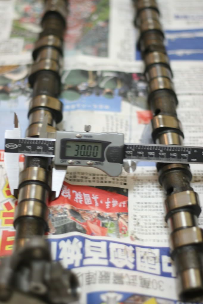

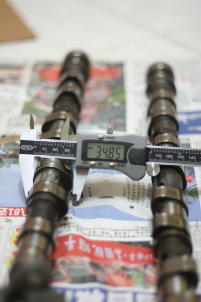

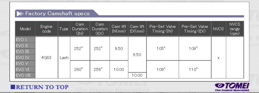

<blockquote data-quote="AvanT" data-source="post: 1064158187" data-attributes="member: 73772"><p>Let me check the airtrek turbo cams in my storage, maybe I can help U all on how to determine whether the cams are genuinely from Evo8 MR =)</p><p></p><p>Measuring the no-lift area of the Airtrek turbo intake & exhaust cams, I got exactly 30.00mm from my trustee digital caliper...</p><p><img src="http://i289.photobucket.com/albums/ll216/wwns75/IMG_1209.jpg" alt="" class="fr-fic fr-dii fr-draggable " style="" /></p><p></p><p>And at the point with maximum lift... 34.85mm</p><p><img src="http://i289.photobucket.com/albums/ll216/wwns75/IMG_1225.jpg" alt="" class="fr-fic fr-dii fr-draggable " style="" /></p><p></p><p>Subtracting the difference, we have 4.85mm per side (radius), a full circle (diameter) would means we need to multiply 4.85 by 2, so that's a total lift of <strong>9.70mm</strong> from our standard <strong>Airtrek turbo cams</strong>. Based on the cam spec sheet posted by bro Stutz, this means Airtrek turbo has slightly more lift than <strong>Evo 4's 9.50mm</strong>, but less than <strong>Evo 7 & 8's 10.00mm</strong> of lift.</p><p></p><p></p><p>Then we're safe to assume that a set of 8MR cams would read more than > 35.00mm if measured & believed to has even higher lift.</p></blockquote><p></p>
[QUOTE="AvanT, post: 1064158187, member: 73772"] Let me check the airtrek turbo cams in my storage, maybe I can help U all on how to determine whether the cams are genuinely from Evo8 MR =) Measuring the no-lift area of the Airtrek turbo intake & exhaust cams, I got exactly 30.00mm from my trustee digital caliper... [IMG]http://i289.photobucket.com/albums/ll216/wwns75/IMG_1209.jpg[/IMG] And at the point with maximum lift... 34.85mm [IMG]http://i289.photobucket.com/albums/ll216/wwns75/IMG_1225.jpg[/IMG] Subtracting the difference, we have 4.85mm per side (radius), a full circle (diameter) would means we need to multiply 4.85 by 2, so that's a total lift of [B]9.70mm[/B] from our standard [B]Airtrek turbo cams[/B]. Based on the cam spec sheet posted by bro Stutz, this means Airtrek turbo has slightly more lift than [B]Evo 4's 9.50mm[/B], but less than [B]Evo 7 & 8's 10.00mm[/B] of lift. Then we're safe to assume that a set of 8MR cams would read more than > 35.00mm if measured & believed to has even higher lift. [/QUOTE]
