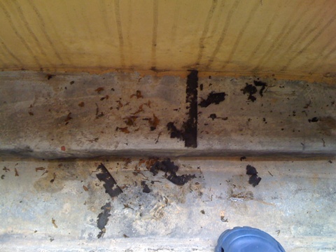

Removed the old sponge. Make sure the surface is clean.

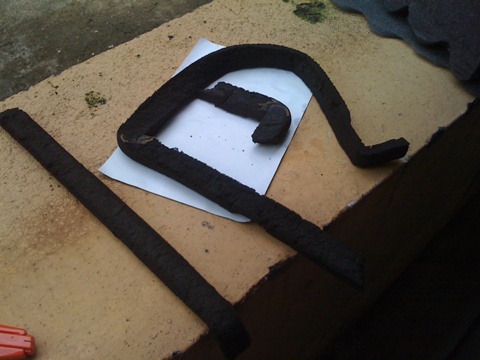

Old sponges which were brittle and dropping off.

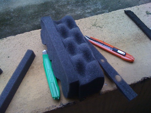

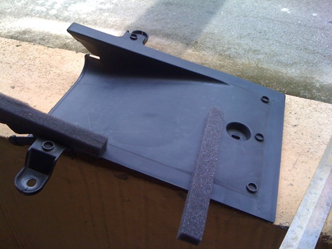

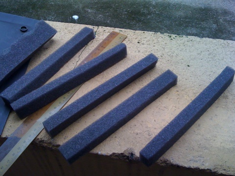

Cut them out into strips. Measure to make like original width and height.
attachment.php

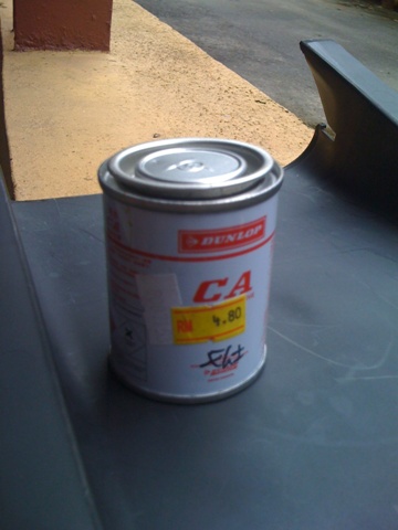

Dunlop glue which I used to 'sedut' during school days.. hahaha

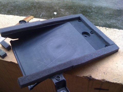

All nice... time to install.
attachment.php

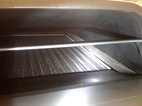

Making sure fitment is perfect.
attachment.php
attachment.php
Works and looks (almost) like original. :)
