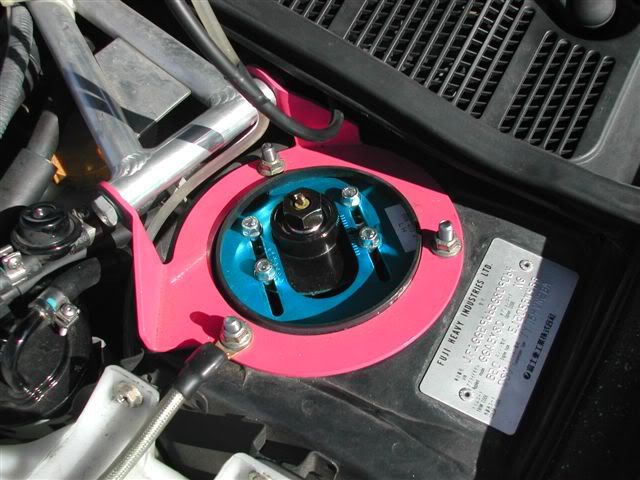

1-find offset lower arm bushes (super pro and whiteline have that..but be prepared to heart attack when u saw the price) :biggrin:
2-get camber+caster adjustable suspension top mount.... i believe ftune suspension have that in stock for satria...
*for scooby to get that was as simple as swapping the top mount from left to right...and right to left... :biggrin: :driver:
For caster angle?....wow....:smokin:
yep..provided the car have adjustable camber plate (top mount)
normal adjustable top mount only allow left-right adjustment for camber
http://i60.tinypic.com/6s3l8p.jpg
ftuned have the version where adjustment at 45degree angle so u adjust camber and caster as well...
for scooby...just swap left and right already have the same adjustment range... :biggrin: not sure if on wira/satria can do the same...
Means still need extra front back plate. Most pillow mount still more for camber only as most do not touch the caster.....:driver:
