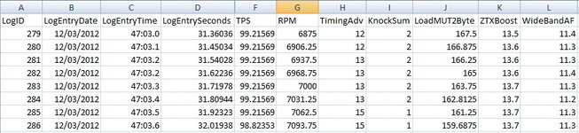

i've been tuning my ecu myself for a while, i'm still newbie, but I've learnt knock, timing, fuel, load, rpm etc, relationship between them to make a healthy and efficient tune.
attached is my log run back in march showing areas where there were 1-2 knocks, the rest were clean. 1-2 knocks is fine for me.
