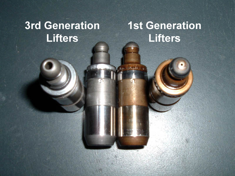

Anyone planning to buy the lash adjuster from http://www.store.partsdinosaur.com/product157.html ? Got discount if we buy a lot. Does a 4g93 DOHC require 16 units?
