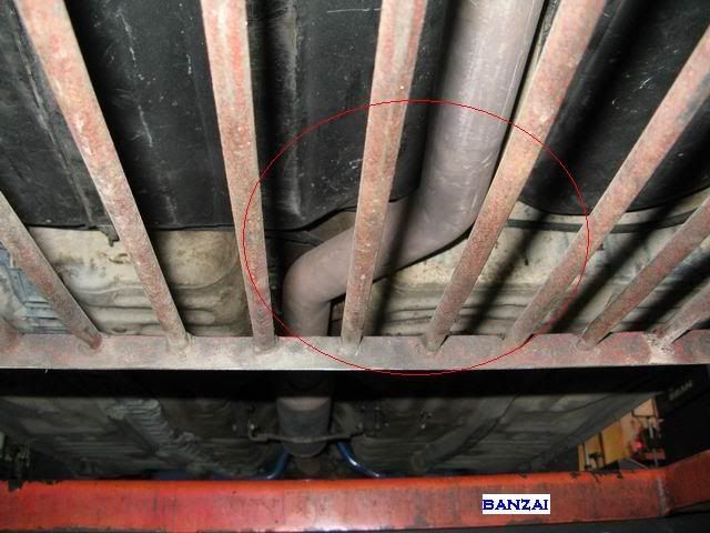

easier to explain..
tat's the ae101 tank groove that enable the apexi N1 piping curve nicely. if maintain ae92 tank, then you just have to solve this part.

see the blue bar? hahhahaha...

wondering this red color hollow bar is custom made to protect fuel tank ???

you all really joker la...pic taken in kedai tayar, tat's why got tunnel with red metal protection....hahaha..
