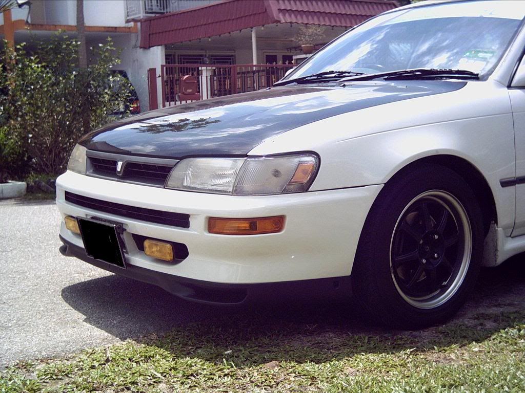

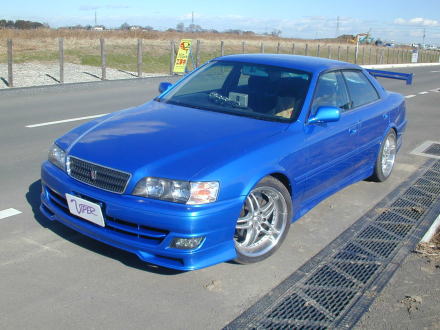

just try to get these front lips if u can. they will just need few adjustment to fit SEG or wagon bumper. these lips are from big sedans of japan, although it looks small in pics, but it is a great looking lips once fitted on SEG bumper or wagon... not much modification needed to fit em nicely as these bumper produce during SEG period, it shares the same curves and whats best is it looks much aggressive than stock corolla lips.... if u trying to maintain the toyota originality, getting these Toyota big sedan lips is the way to save.... but most halfcut don't bring these lips down to msia as they think it is worthless here and not fittable.... i most of the time ordered these lips and have to wait 2~3months before arrive, in some case if it arrive msia, you will have to buy the whole bumper to get the lips.... duhh
1)JZX90 (Bro -AFM- here is your lips)
2)JZX100
3)A32 Cefiro (No pics)
4)GX90/LX90 Cresta Chaser or etc etc

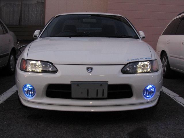

U can also use AE111 levin or trueno lips but have to add 2 inch of plate or anything as AE111 have shorter width than ae101.
1) AE111 trueno (smiling looks)
2) Ae111 levin (2 lines at the side)
3) 6 speed lips (small like FX lips)

bros, want to ask if the "oem" lips from the Chasers jzx 90/100 are PU or fiber.
would a jzx bumper fit an seg?

ABS plastic is the material. I used one and it is really really tough lips....although raked divider, still can be repaired as long as not "koyak"
The bumper cannot be used at all for SEG but if u want other car bumper,

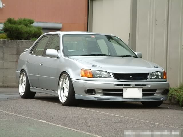

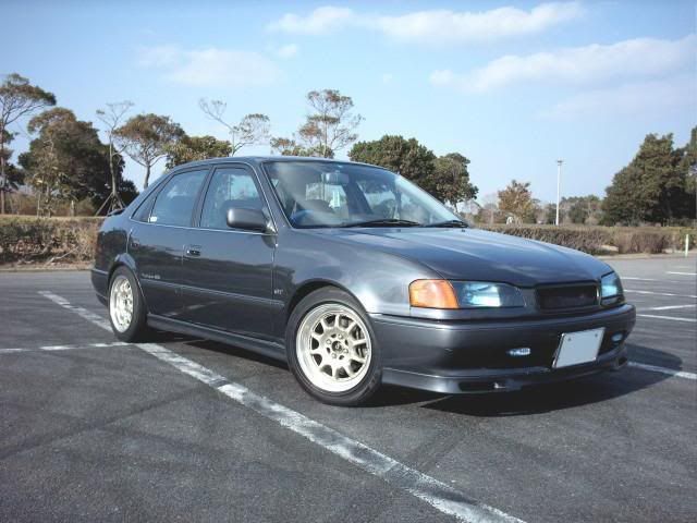

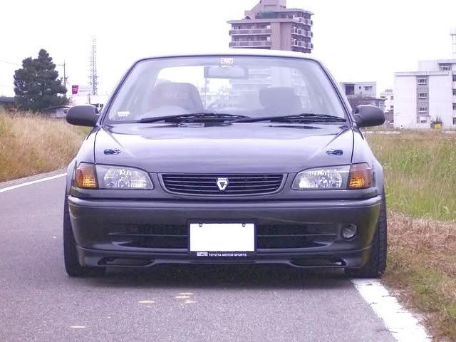

Here is samples lips fitted on AE111
1)JZX100 lips on AE111
2)A32 Cefiro lips on AE111
3)AE111 levin 5 speed lips on AE111

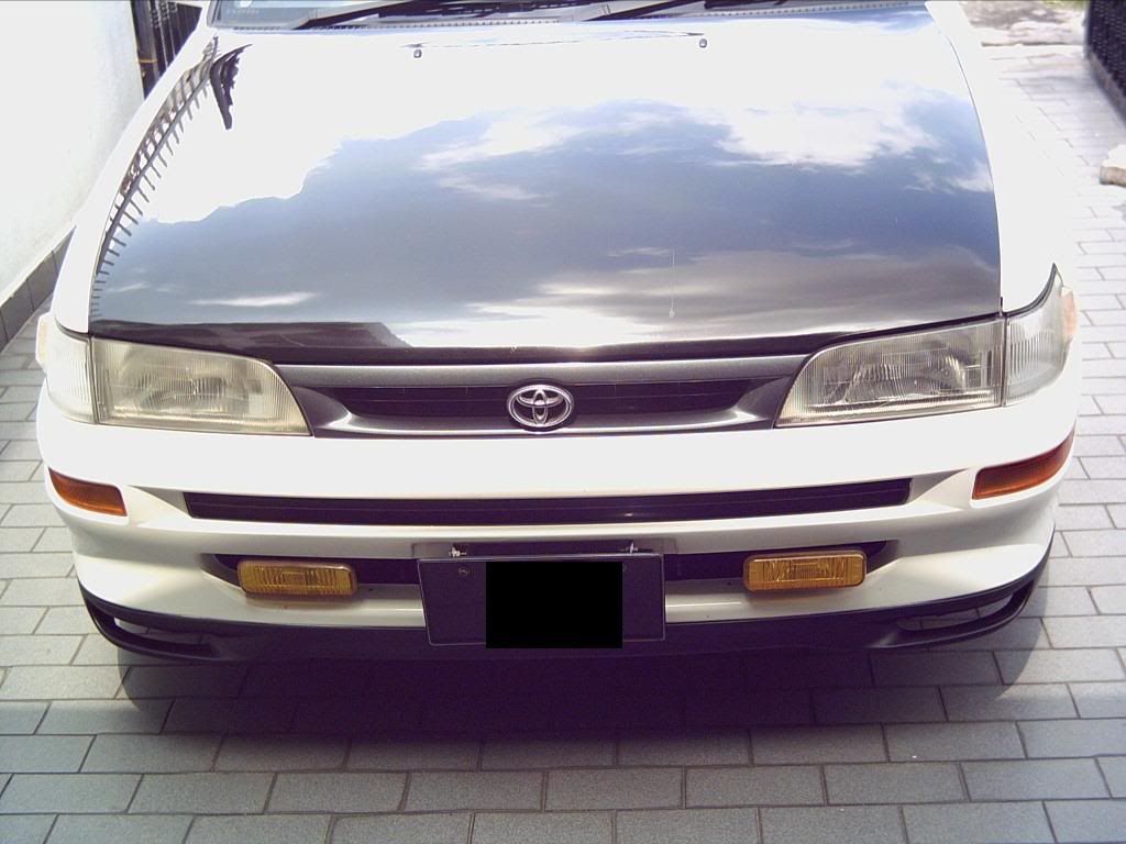

DAMM! the A32 cefiro's lip looks damm good on the rolla man!
As for the JZX one's fitment seems superb, but if flare out abit should be nicer.
Btw, how are the lips mounted? not rivets i hope...

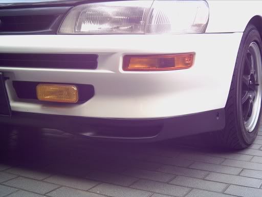

the lips can be mounted using the existing bracket, as i say no need to rivet as it have the same curve and contour like SEG so rivets arent needed to force it to bend. just need to skru the brackets.
here how it looks like on my car, X car that is.... I painted it in flat black so it will be easier for me to repaint it myself everytime i scrape the road or devider hehehe
