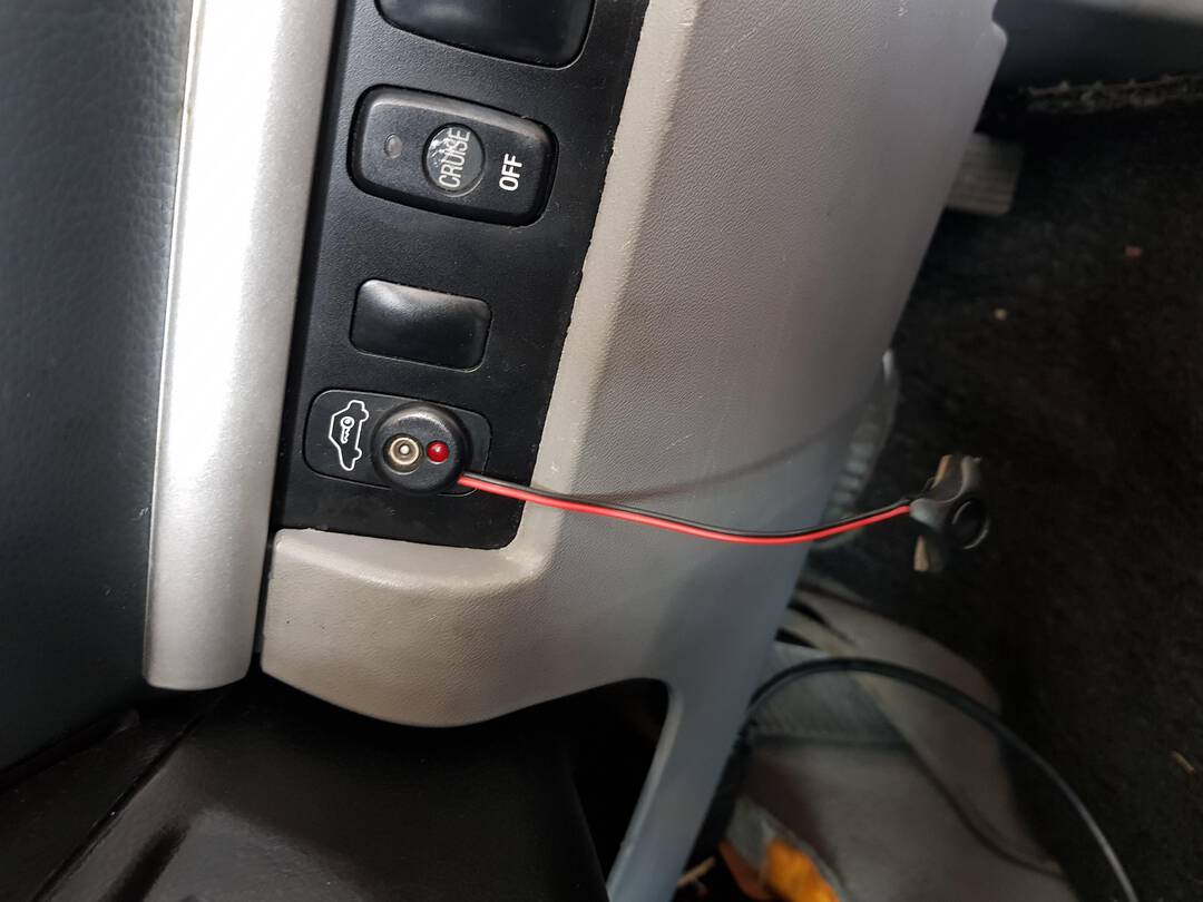

Anyway, after checking the flywheel sensor...my worst fear came thru.the problem has nothing to do with the flywheel sensor. Further check reveals the cobra unit is built into the ecu and if unlucky as in my case,it will fail.
To solve it...change the ecu.Now thats easy as 2nd hand ecu can be source from as low as 300 to 500. Problem is that most 2nd hand ecu does not come with the immobiliser touch key so it wont work. The code it built into the ecu and tied with the touch key.
Will call proton on Monday to see the potential damage to my wallet. If any of u guys happen to know any 1.8 ecu is for sale with the immo touch key, do let me know.
Plus, will try and get in touch with the guy on FB whom repair ecu and other electronic stuff.

Update,
i manage to get hold of a used ecu with immobiliser key at bargain price of RM300 from Alor Star. Was a RM300 gamble but after few whatsapp msg can see the seller is genuine.
Now waiting for it to arrives, based on tracking number the item has reached Melaka on Sat but City Link is super slow as only yesterday it reached its distribution center at Batu Berendam....so close yet so far.
The first place i will drive the Waja after it runs (hopefully) is the tire shop.Damn screw puncture the brand new rear left tire before the ECU died.

Go and pickup the ecu at City Link distribution center..Wonder how they survive all these while with super slow service.
Went home and install the ecu, connect the battery, and....it still wont start.Immo light still not blinking.
wtf....well not so bad as i now have spare ecu with immo key at super low price which i can resell for double what i get it for.
I give up, will tow it to Proton on wednesday. Really upset as i could not solve it.

crank sensor has been cleaned...tedious job as the sensor is hidden,those with short finger can forget about cleaning it.
Will try and swap with spare unit if i can still find it.
I have a theory last night, the immobiliser works by either cutting off spark or fuel in order to prevent unauthorised starting. If lets say the fuel pump is kong, will it caused the immo not detecting it and not functioning at all?
I did try normal procedure to start the engine by touching the immo key once assuming the LED is burnt and not blinking, still doest work. Tried the emergency bypass procedure but the led does not blink meaning it does not detect my bypass procedure. This could oso mean the touch point circuit is kaput...
