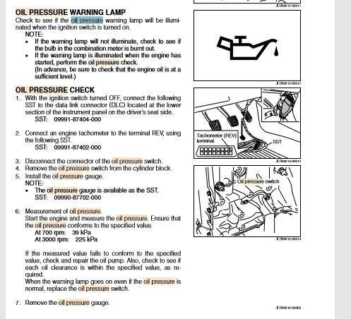

punk
punk
Aug 6, 2011
361
76
528
Negeri Sembilan
The foremen in charge for my car's was on leave since 30/12/2017 till 3/1/2018... He says that he has since changed the original oil pump(or is it called engine oil pump i'm confused) when the check engine oil indicator lights up after he starts the engine ( which indicates low oil pressure/low engine oil in engine), so he changed a new oil pump switch (is this what you meant when you talked about some sensor?) but after installing everything & the lights were still there after starting the engine again..
They did, use a computer to scan the problem but it is still showing faulty E/O Pump switch... When i last left the workshop last saturday on 30/12/ .. They were seen disassembling the engine for the 3rd time after the sub-foremen just can't seem to figure out what seems to be the problem even after troubleshooting the related error with that light...
What astonished me was... the engine is silent & doesn't seem to have any noticeable error during engine start, but only the error lights were illuminating.. To play safe the mechanic's suggested to solve the error lights first to prevent any damages that lead to more unnecessary money to be spent on...
Hope this help.
