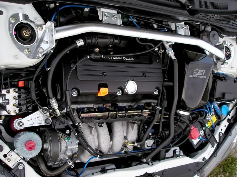

the OEM front strutbar mounting point for pre and facelift are not the same. pre facelift strutbar is mounted on the chassis whereas the facelift are mounted on the suspension bolts. nevertheless aftermarket struts should fit both models. if you're talking about carbing 4-points strutbar i believe the EDFC servo could be fitted nicely since there is ample clearance around the bolting points.
prefacelift strut
facelift strut
carbing strut
i didn't why that the servo couldnt fit on yours but i think another facelift friend did not face this issue with his EDFC. he's using OEM strut to my knowledge. hope this helps. cheers
Certain bars such as Mugen & J's Racing will possible hit the EDFC motors, sometimes dependent on the camber angles.
but Carbing (4 point version) so far no issue, 100% clearance.
Cusco titanium engine bar also no issue, tested and confirmed.
