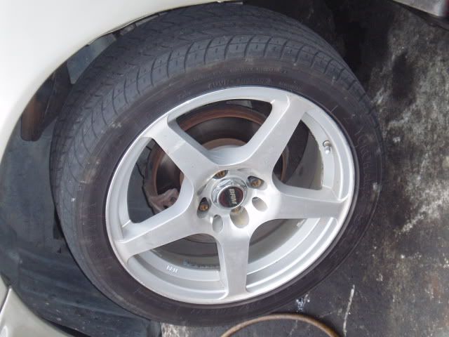

before the operation start.jack up ur car.take out the tyre.

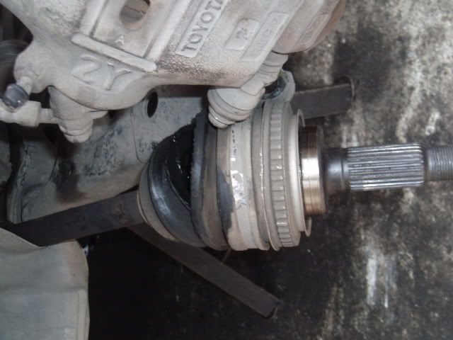

http://i3.photobucket.com/albums/y61/amirizal/driveshaft%20ae101/Picture001.jpg
there u go.pic of tear bush

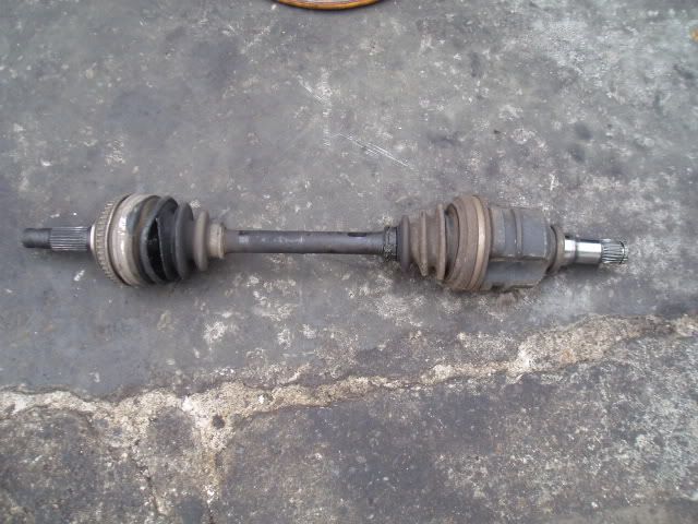

http://i3.photobucket.com/albums/y61/amirizal/driveshaft%20ae101/Picture003.jpg
whole pic of the driveshaft

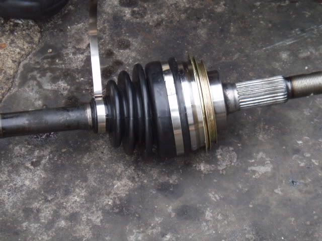

http://i3.photobucket.com/albums/y61/amirizal/driveshaft%20ae101/Picture004.jpg
put new CV joint.buy new one.comes together with bush,grease and tightening reel.RM150

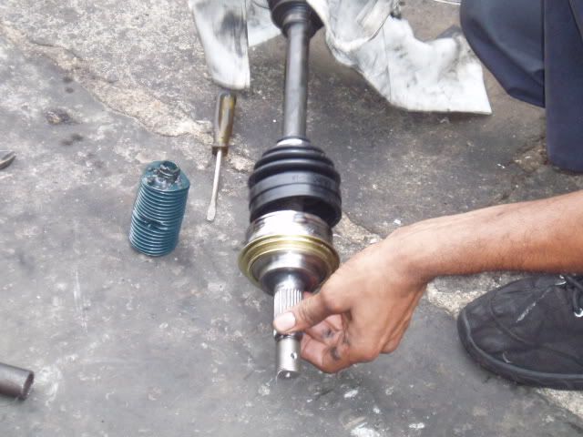

http://i3.photobucket.com/albums/y61/amirizal/driveshaft%20ae101/Picture006.jpg
tightened evrythin.ready to put back in place.
