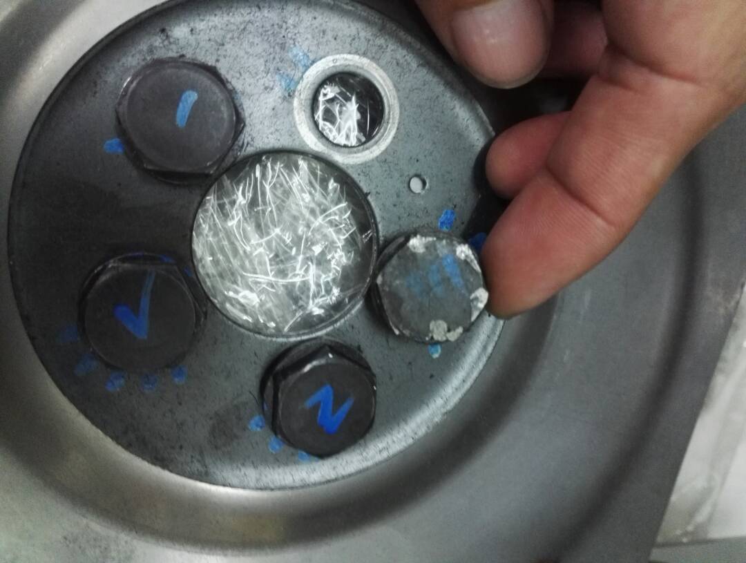

how u tighten the flywheel bolt without slip?
u using airgun or by hand?
i slip one of my bolt using 17mm hexagon socket.
Or i should using inch socket?
I use an airgun with a 6-sided impact socket and need to make sure the socket sits properly as even a slight misalignment can cause it to slip. You can try inches see if it fits better or not, but I'm not sure of the effectivity of that
