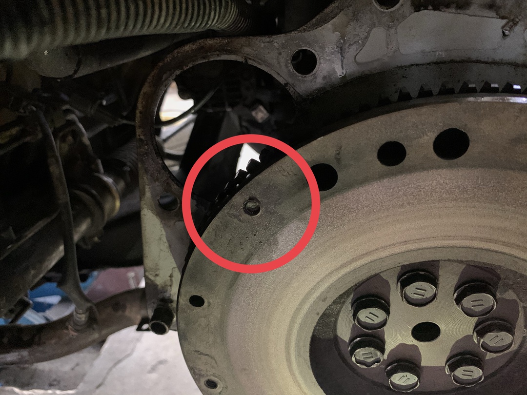

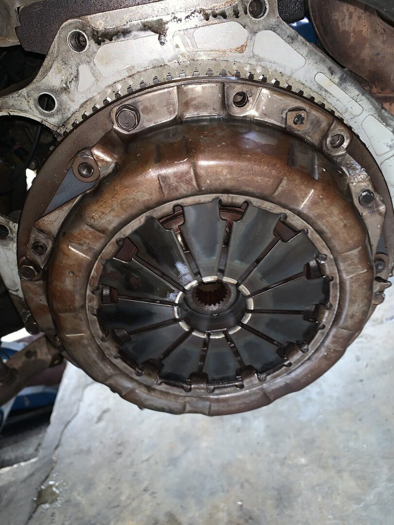

Hello all, been too long since I last camped in here My Satria has finally got into a new set of problems which I can share here!
All started when I noticed puddles of oil where I parked. It wasn’t engine oil but gear oil, leakage was near the flywheel so had no choice but to drop the gearbox. As you can see..
supposed to be oil-free but it’s clearly wet
punctured housing, that’s where the leakage was from. Something must have broken!
One of the flywheel nuts were broken, couldn’t find the fragment. With this, it has damaged more parts..
All edges of the clutch cover
clutch springs have been hit
It all happened so quick that the gears showed no problems of noise and shifting except for the leakage. Car is sitting at my mechanic’s place now. Already bought new clutch set, pumps, drive shafts and some minor parts while we are at it.
