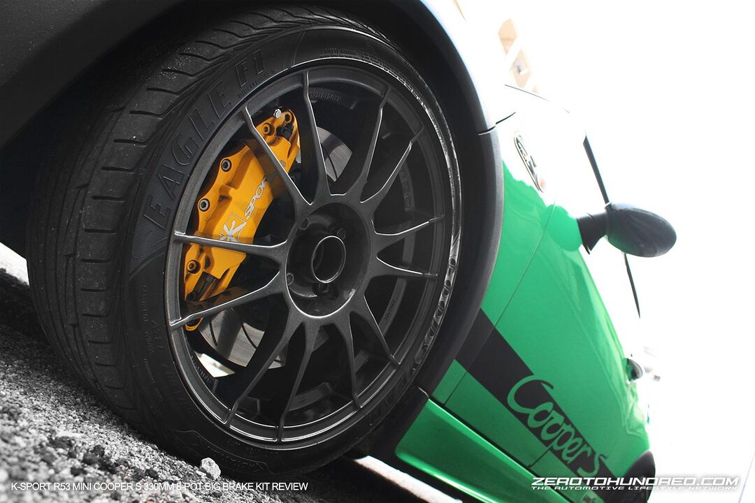

Above: The MINI with front K-Sport 330mm BBK fitted. Barely nestling beneath the 17X7 OZ Ultraleggera wheel.

But today, you’d be glad to know how much they’ve advanced in their choice of materials and built quality. At least, for the K-Sport brand I’m introducing in this article. On first impression, I’m pretty impressed by the look and finish of the kit. This kit in particular is a 8-Pot caliper system with a 330mm rotor and is made for the 2002-2005 R53 MINI Cooper S. Perfect for our Signal Green MINI. The Yellow powder coated calipers matches perfectly.

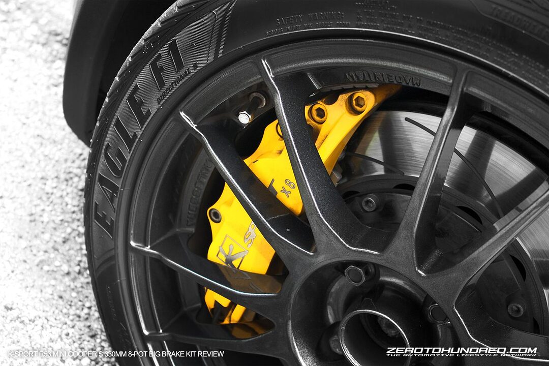

Notice the differential bore sizes on the caliper, a design feature in all performance brake calipers to combat uneven or tapered pad wear. Having driven on the K-Sport BBK for about 5000km now, I’ve come to appreciate the purpose for more pistons. Any 4 or 6 pots should stop as well as a similarly sized 8 pot caliper. But the difference here is how the foot pedal pressure is distributed among the pistons. This results in a braking feel that is highly progressive and provides greater control of the brake pedal pressure. Perfect for a daily driver.
Here’s a comparison of the rotors. 330mm K-Sport on the left and 320mm Brembo on the right. The grooves embedded in the discs clears gas and dust build up during spirited driving. Just like Brembo, and other known aftermarket big brake systems, K-Sport offer floating rotors in all their kits as well. Having a separate bell and rotor not only eases production to support more car applications, the true benefit of floating rotors is that they save more weight as opposed to a solid cast-iron rotor. Rotor hats / bells are typically made of aluminum. That 10mm increase in rotor diameter from our previous Brembo GT isn’t much, but would deem beneficial, since any increase in material is a good increase for better heat dissipation.
