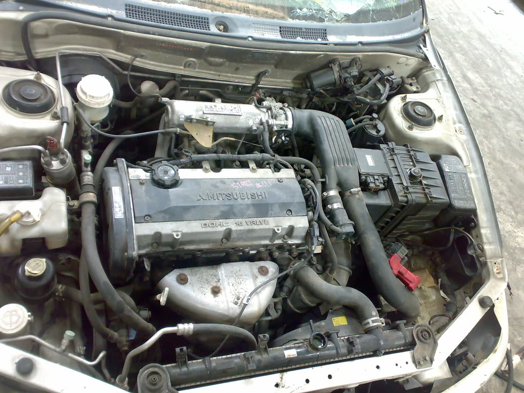

I found this video on YouTube yesterday. I was quite confused with this setup. What kind of benefit can the owner gain from this setup and how did the mechanic managed to reverse the position of the intake and exhaust? The valve cover is still positioned like normal though.

The video says it is 4G93. But 4G93 intake is on firewall side while exhaust is facing front. The one on this video is the opposite. Intake facing front, exhaust on firewall. :confused:

4G93 CA engine with 4G93 CK head
CA engine (wira/satria/putra chassis) = timing belt on rightside
CK engine (lancer/ mirage chassis, engine ngam2 fit into waja/persona/gen2/neo) = timing belt on left side
so when CA + Ck head, in order to meet the correct CA timing belt side, so the CK head is reversed installed.

Nope, that is not a CK head. Initially I thought so too but after looking carefully, I found out that the head (valve cover) is from the old 4G9 series not the new 'terbalik' version.
Here, look at this area that I highlighted. There is this gap area to accommodate the plug cables in the earlier 4G9 series engine.
But it is not present in the CK series of 4G9 engines.

Probably he manage to use that cover on the K head. If you look at radiator top hose it goes to the rear at firewall side

Maybe you are right... Such a weird setup. So many things needed to be custom made. If he is using ITB for intake, then perhaps I understand why he wants the intake facing the front but he is not using ITB setup...

that is 1st gen mivec rocker cover..mivec head got 2 deck..maybe they mix both 1st & 2nd gen deck together or what i also dont know
but i still wonder how they put it together and got it in running

it used 4g92 mivec ck head mix with ca block. it is not 4g93 head.
this modification becomes trend lately.
1 of my friend's neo, using CK block with 4g93 CA head mix with ITB config. manage to churn out almost 200whp a t wheel.
