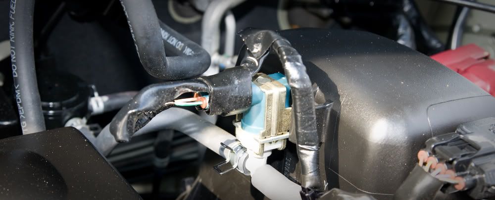

1) Evaporator (near air filter)
- Problem : Engine light comes on because the wire connection to the evap sensor unit is bad or broken. This is because this part of the engine always vibrate, and thus affects the connection after time.
- Solution : Replace wire with a longer version.
