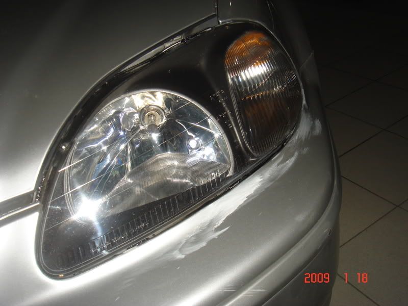

Just to share =)
This is how mine turned out, started with matte black then sprayed on with Gerhana Grey, result's almost like gunmetal in my opinion =)
