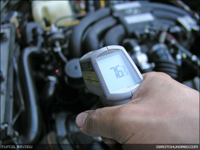

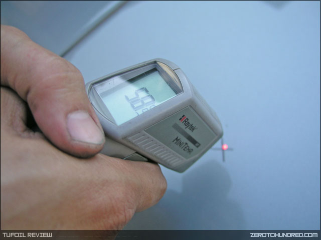

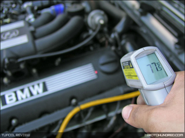

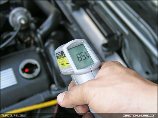

  • After leaving the engine to idle for 5minutes, then, while
    idling, temperature was taken (positions marked and distance between the gun
    noted) at the:
  • Bonnet : 58.5oc
  • Engine Head Cover: 77.5oc
  • Tappets: 85.5oc
  • Water hose from the engine: 76.5oc

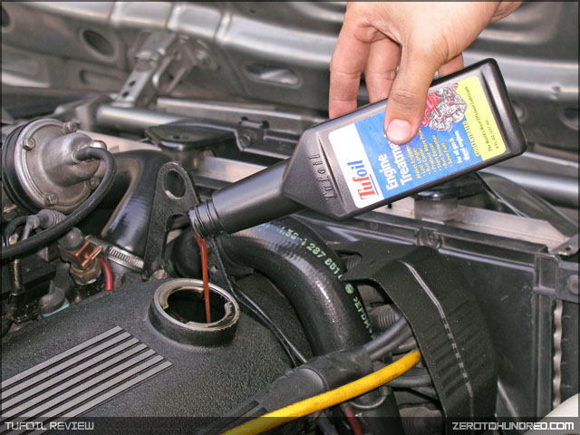

  • 1 bottle of Tufoil was poured in
  • The engine then was started and while running, the engine noises

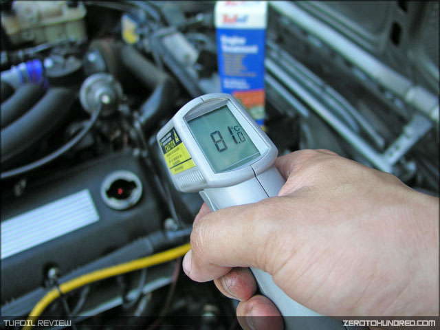

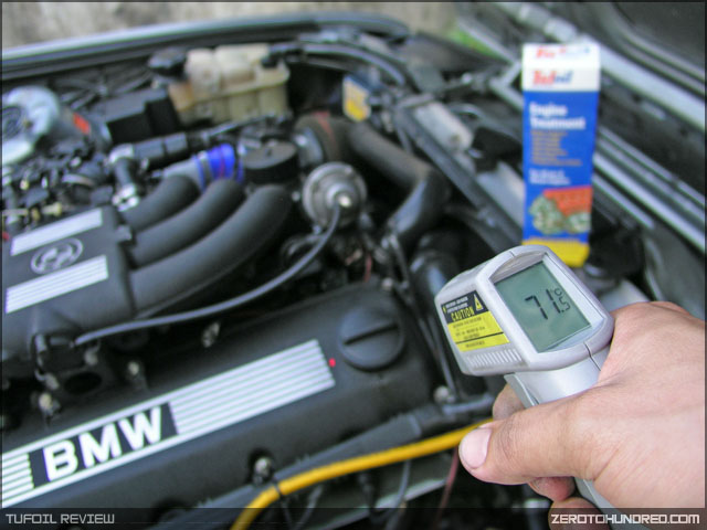

  • After leaving the engine to idle for 5minutes, then, while idling,
    temperature was taken at the:
  • Bonnet: 55.0oc
  • Engine Head Cover: 71.5oc
  • Tappets: 81.0oc
  • Water hose from the engine: 75.5oc
