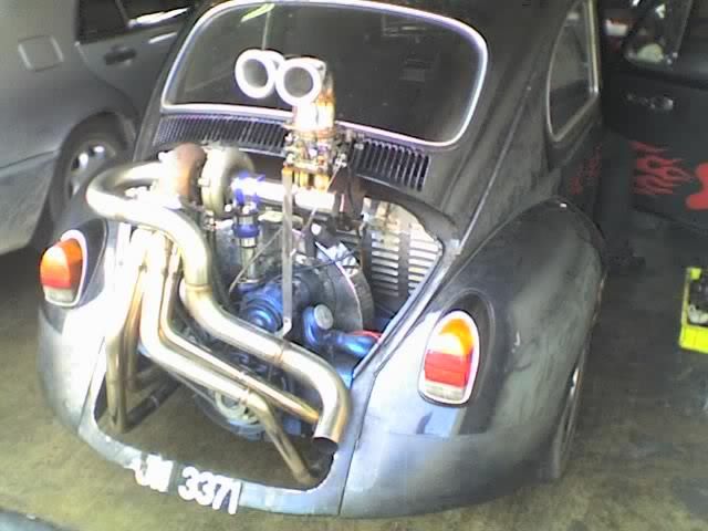

but from what i read from oversea articles, it is not impossible to bolt on turbo to carburetor engine.... jz dat tuning is harder and not feasible for everyday ride...
bot carbie engine has 2 method... blow through or suck through...
in the blow through method, carburetor is placed after the turbine... means the air enters the carburetor is already pressurized... for this i not sure oem carburetors can handle the positive pressure or not... not to mention, it is hard to tune the AFR mixture...
suck through method however is much simpler... carburetor is placed before the turbine.... means the air blowing through the carburetor is negative pressure (similar to NA).... tuning is much simpler but there are a couple of downside... u cannot use an intercooler and AFR mixture reaching ur engine will varies alot due to lost of fuel when it travels through the turbine and pipings....

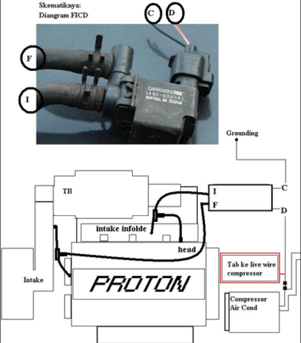

Thanks Zamiex for the photo. Do you mind to tell more about the picture? Such as what is installed/replaced and how to tune it?
Looseand, not all Proton 1.5 engines are carburetor. There are fuel injections too.
