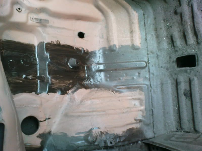

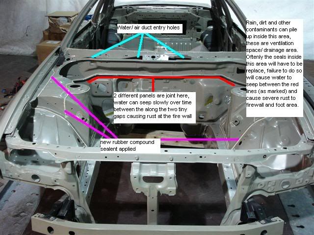

here is the common cause of firewall, engine bay area
Failure to add new sealent to the drain area will cause water to seep through every hairline gaps. it could happen to your car, so, start adding sealant before you discover red annoying spots on your pedal area.
Once water find its way through the joint area, it can cause rust EVERYWHERE inside your engine bay.
So for those whom planning to repaint etc etc...why not spend more time replacing:
1) Underbody tar
2) Drain/weld joint sealant
3) Pump oil into the chassis

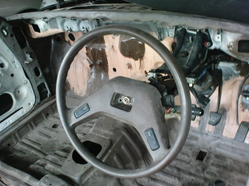

This guy is and honest person, I sent my corolla KE70 for full restoration which is
1) Removing Everything to bare chassis (not a single bolt on the KE)
2) Remove old undercarriage tar to bare metal and respray
3) Replace rusty area
4) restore KE70 chassis to NEW FACTORY like condition. Spot weld
Other shops requested Rm8000, i went to 15 shops for price, hairul only charged me 2.5K and the result is astonishingly like new... even the floor contour and surface are maintained unlike other shop that will simply paste and weld a plate to replace rusty area. But this restoration nearly took 8 months to be completed.

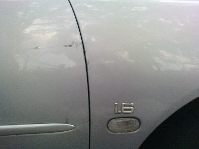

Here is a sample of a car he have repaired
This car have met with an accident and i didn't took pics of the car before it is repaired..

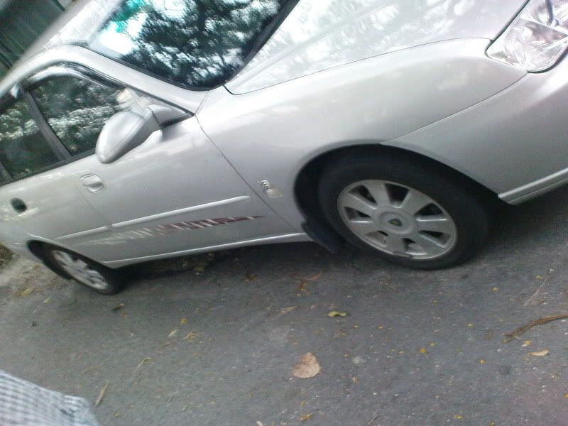

This waja suffered
1) Front fender dented
2) Door from front to the rear fender before the rear lights
My friend skidded his Waja in a rain and hit a devider.
This car have been repaired by Hairul and NO REPAINT DONE, just deep scratch left, that is the only mark left after his work done

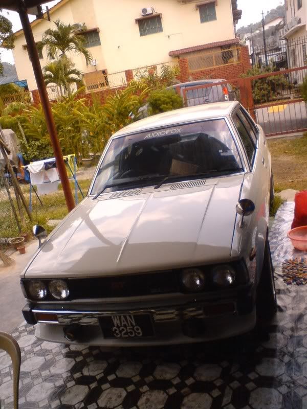

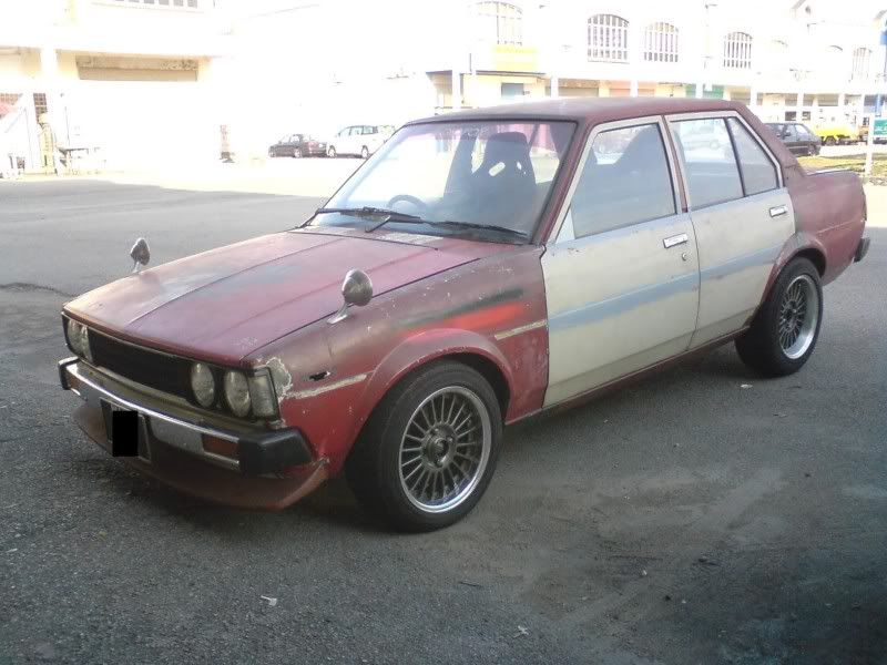

BEFORE
AFTER
KE70 in my memory

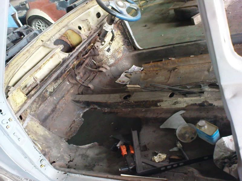

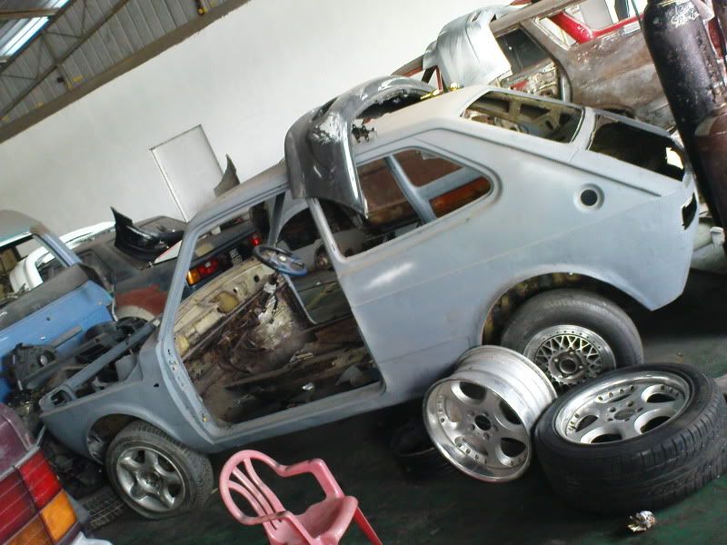

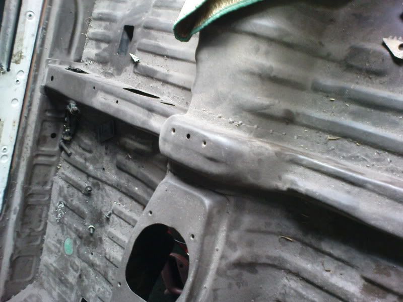

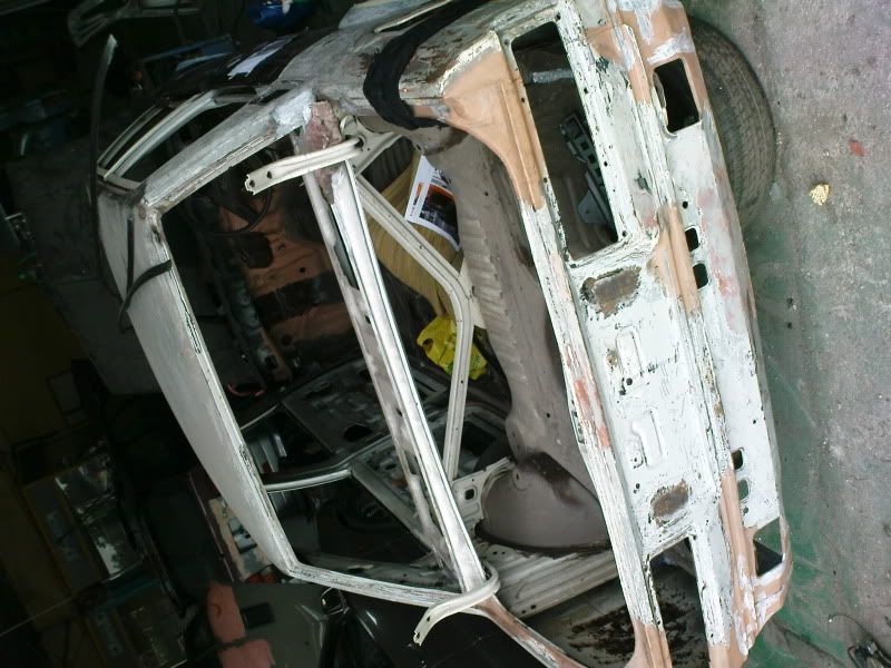

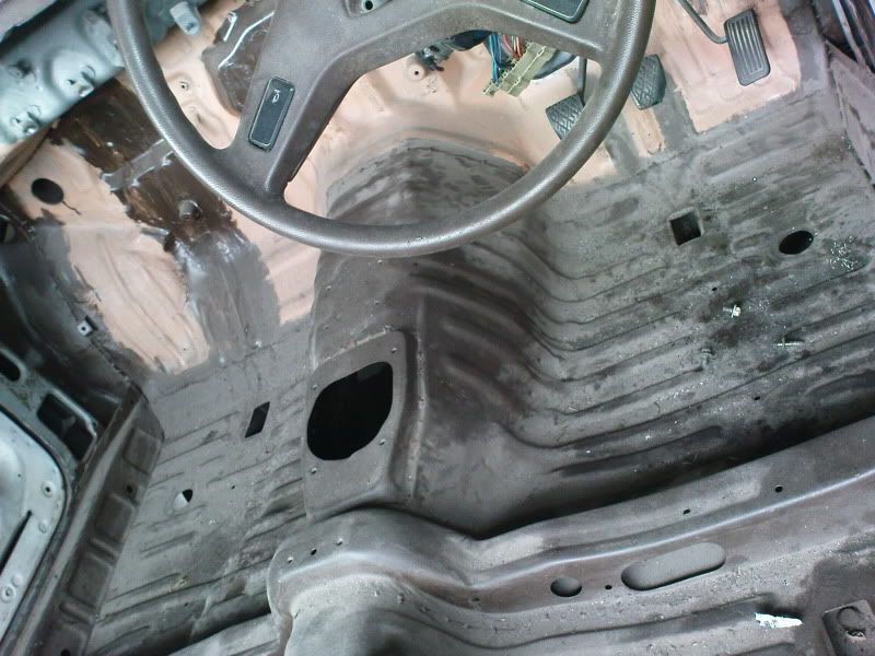

I went to Hairul's shop today and took some pics of an old fiat and KE70 under restoration process...
Try to see whether you can differentiate between new replaced floorpan and the stock factory ones.....
