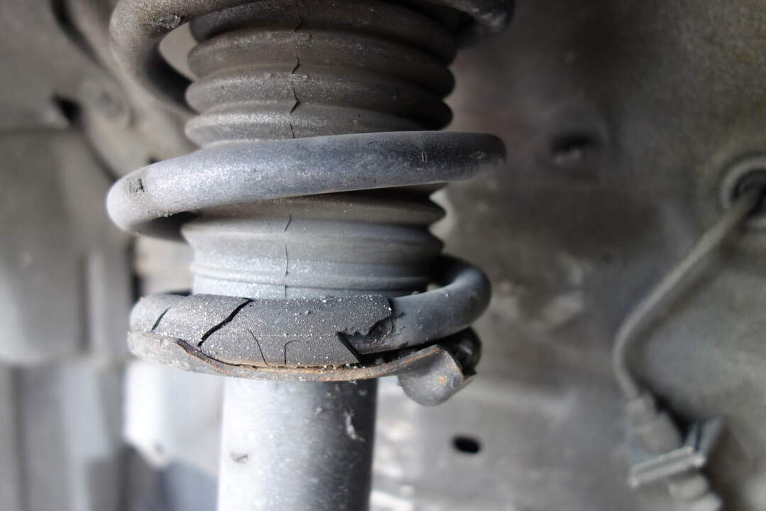

I noticed that my Myvi had cracks on both springs for the front suspension. I don't think this is normal and is it dangerous if I leave it this way?
Here are some photos of it for both right and left side.
Thanks for all your feedback and help.
Right side

Nope, it's not crack on the spring itself. The cracked one is the rubber covering the spring, so no worry.

Erm.. Could you clean that part of your spring with water and soap just to confirm it's not the spring? It looks very unlikely a spring crack but just to make sure just clean it up, and retake the pics.

Okay. I'll try to clean up that part.

I 99% confirm it's the rubber cushion cover cracked. My friend previously notice this and very worry. He bring me along to workshop to have a check on the "cracked" spring. After taking out the absorber and found out it's the damn rubber cover. I checked on few myvi with original absorber, they're the same "behavior".

Better make sure, but I doubt that it is the spring cracked. Some part quite bad already and should have snapped if already cracked....
You got point in this. After checking back some old photos taken during wheel rotation from last year, I noticed that these cracks are already there. Most likely it is the rubber that is cracking then.

The workshop is reliable and quite cheap. The workmanship including taking off and putting back the absorber + wheel alignment . Just don't worry, your oem spring is still good.
