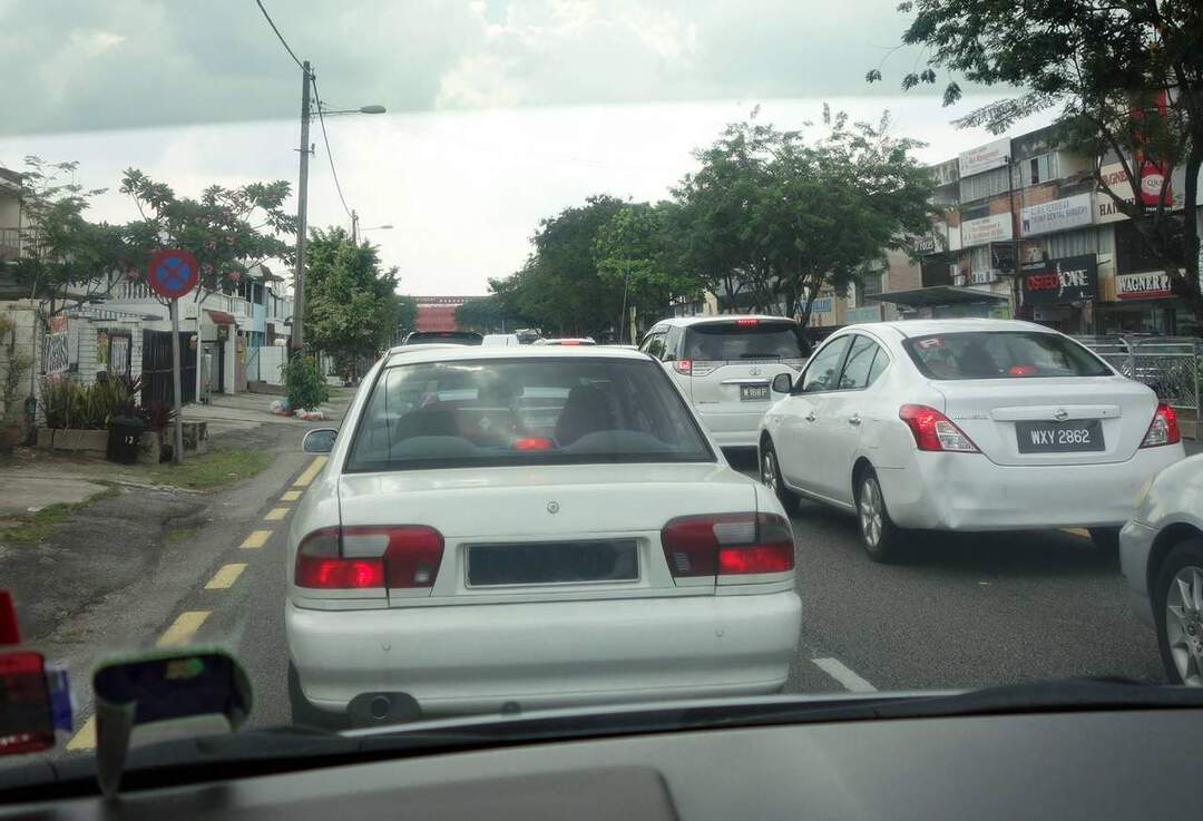

This is just a curiosity question. I noticed that many Wira's rear brake lamp does not lit up fully but half which is on the outer side. Meanwhile for mine, the whole brake lamp lit up fully unlike those who only lit up half. Does this mean that there are 2 versions of Wira rear lamp or those that lit up half are actually faulty?
Here are some photo showing what I meant by fully lit and half lit.
Half
Full

hmmm.. i think my tail lamp brake lights not fully lit. :hmmmm:
oh wait... the first photo showing brake lights only. second photo showing night lights with brake lights. LOL
Second photo just night lights without brake light. Notice the 3rd brake light is not lit. :biggrin:
Will try to take a pic of brake lights lit later after work today for a better comparison.

Mine with just brake lights on. I do notice the inner side of the lamp is darker but it is still lit up unlike some that is totally not lit.

I'll have a look after work today. Just now on the way to work, I tried observing other wira brake lights. Seems that all of them are only half lit. Maybe something is not right with mine?
Yours looks like half also.......lol
