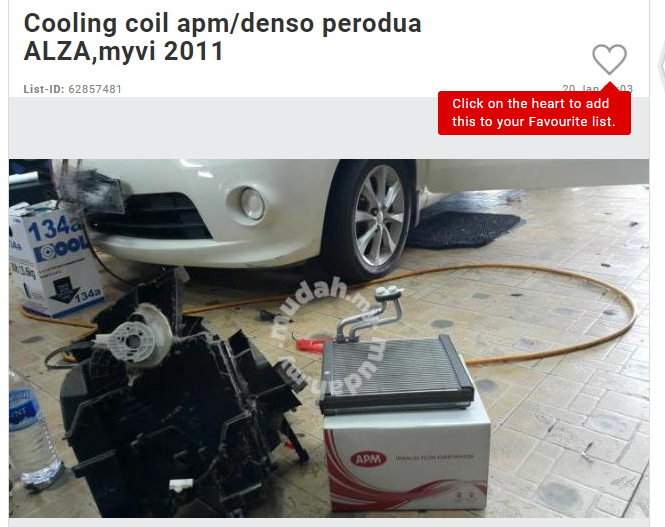

Based on blog attached below:
Myvi 1.5 Compressor can fit Myvi 1.3 but need some modification on belting adjuster bracket.
Myvi 1.5 compressor does look bigger compare to myvi 1.3 compressor
http://senangeja.blogspot.my/2017/06/kompressor-myvi-pecah-magnetic-cluth.html
Myvi 1.3 and myvi 1.5 cooling coil size look the same for me.
Bigger compressor is like a house 1hp vs 1.5hp air con, so should cool faster and better but will zap some power from the engine since only 1.3L....lol
