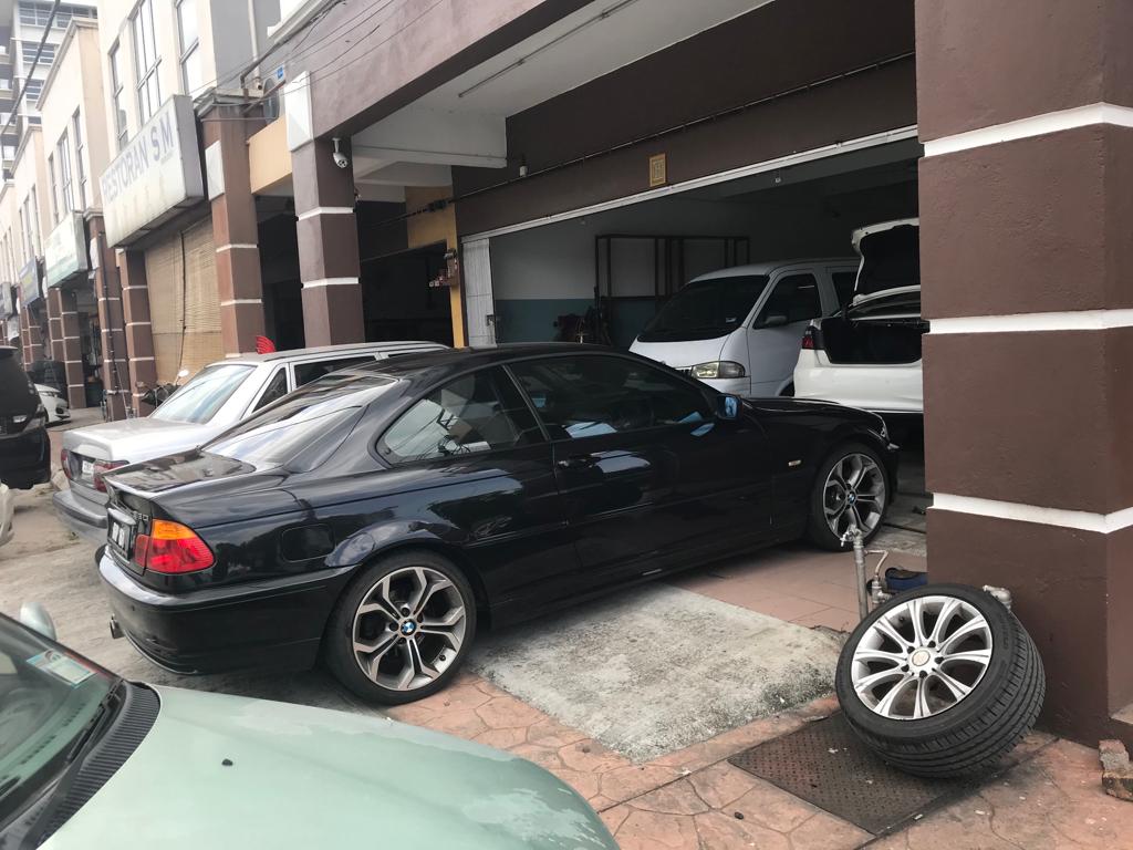

Dear All,
Just came back from fitting a new set of rims with busted old tyres of mine that i am still keep it for emergency use, thank god i am still keeping it so i can immediately put it to use. I speed up to 190 km/h just now, looks like the rear seat vibration is rectified and now mostly is the steering wheel vibration due to this old tyres can't be well balanced anymore. The centre bore is very tight fitting without the need of centre hub ring. I will fit in new 18' tyres this weekend and have another round of proper test driving. Hopefully this will solve the issue once and for all. {Picture below for the rim i am using. It's from a BMW X3.
