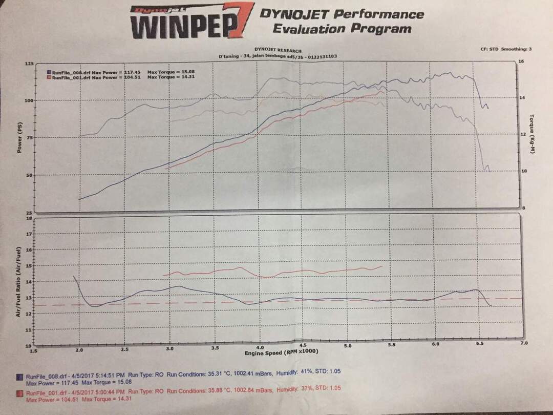

Hello guys, just wanna ask, i bought a neo 1.6, and the spec are :
1. Haltech Interceptor Piggyback
2. High cams
3. High compression pistons
4. Full race clutch
5. Final drive
6. Stainless steel straight pipe
7. Carbon fibre open pod intake
8. HWL adjustables hi low soft hard
9. Steel braided brake hose
10. Ssr rims + toyo tires
11. Lightened crankshaft pulley
12. Works fuel rail
13. Denso spark plugs
14. Aftermarket spark plug cables
And i went to dyno and it shows 117 hp, is it normal for this mod to gain 117 hp? Or am i expecting too much?
Hope to hear something from you guys or any advise or anything, thanks

from your all long list of mods...not all contribute to power increase...,
-interceptor piggyback to tune the engine
-highcam <- what was the spec?
-high conpression piston <- saga blm piston?
-fuel rail for bigger fuel flow (if your engine can consume much more than stock fuel rail deliver)
-cf open pod (if your engine can flow more air than stock intake)
-fuel regulator (supply higher pressure if your engine demands it)
so... i would say 117wheel hp is sounds about right with just cam and piston change...
if u want higher power, u need to look for head bigger port, bigger tb, tuned exhaust manifold nd adjustable cam pulley...
(*actually i saw this thread in pc..but since at work i cant tahan and reply it via my phone) :driver:

Considering the new car is 110bhp on paper (probably 105 on wheel or less), 117 is seemingly low. But if you can show the graph more can be commented.

Neo has two engine specs right? The 140+hp and the 120+hp if I remember correctly. If the 140+HP, then std on wheel should be around 110-120, so if the mod is done on this spec then they're practically useless. However on the 120+hp engine, on wheels should be around 90-100? So if the mod is done on this 120+hp engine then it gains about 17hp or a bit more which sounds not bad.
CMIIW though.

I help him share the chart again.
The graphs look erratic... the blue/green line is the final run. can see some spike towards the rev limit there. :hmmmm:
TS got no ACP for the high cams? It's not in the list.
The graph is in my attachment, idk how to put it inside my message, sorry sifu all :/
Wow is there so many peaks
