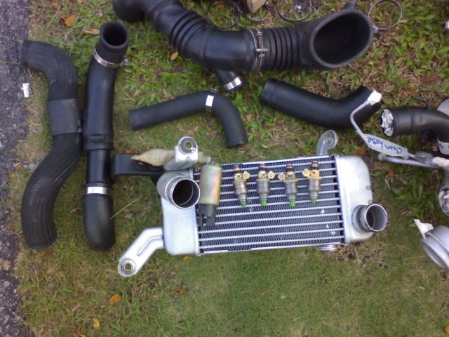

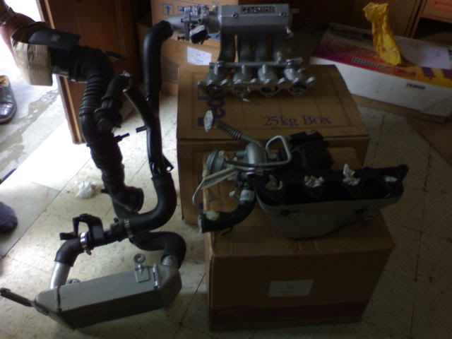

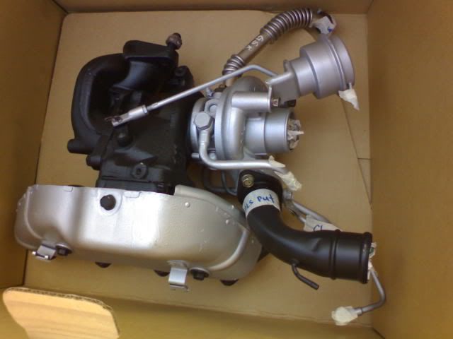

I dunno how to explain well so i include pictures for my question..
This is the box that i mention..
the red round mark is the join with red round upper picture...
