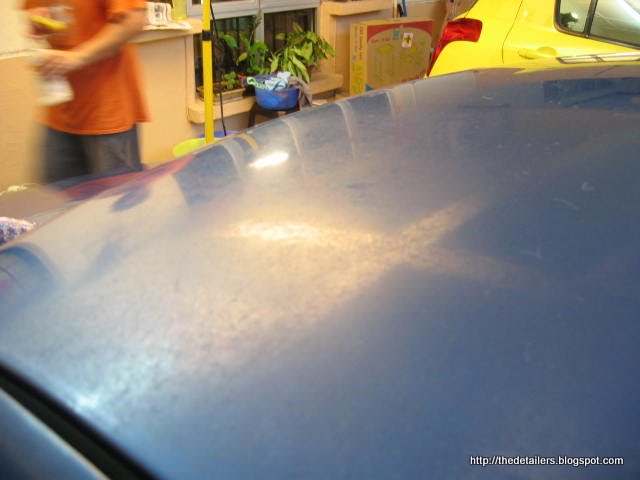

the 50/50 % area set.....
ready
get set
Bang!!!! Go
as there is always darkness before dawn
before
coming
coming

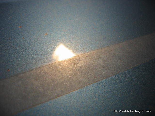

After Megs 105 with LC CCS Cuttinf pad…very impressive outcome
Look at the restored side, & the oxidize paint look like a racing stripes
impressive restorations
extreme close up Racing stripes….
you may also see the paint chipped, perhaps by stones at high speed!!!!!

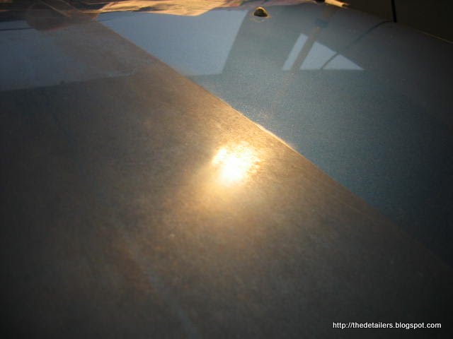

M105 Megs LC CCS Cutting pad….is not as aggressive than the wool cutting strength
the finish side of wool
look at the side left panel not corrected…& compare with the hood now
NOW SEE THE DIFFERENT

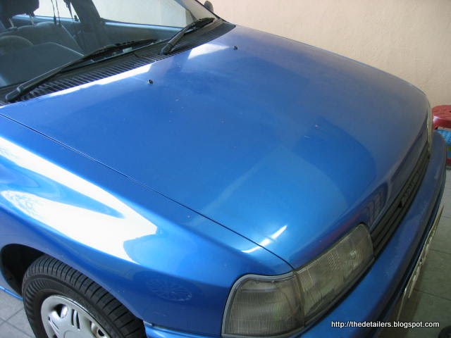

the most extreme make over, close up Picture
Look at the 50/50% comparison before & after
the champion of of the champion
