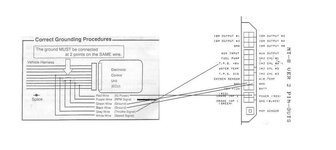

T talam_buruk Known Member Senior Member Feb 7, 2004 181 2 3,018 Jan 23, 2010 #1 Need some guideline here, where should I connect the 1) RPM Signal 2) Speed Signal [/IMG] Thanks in advance Attachments avcr+microtech1.jpg 30.5 KB Views: 308
Syahz Known Member Senior Member Aug 14, 2009 484 21 1,518 Australia Jan 23, 2010 #2 Rpm from microtech is IGN output 0 Microtech have no out put for speed signal from ECU.(only haltech Platinum 1000) Last edited: Jan 23, 2010
T talam_buruk Known Member Senior Member Thread starter Feb 7, 2004 181 2 3,018 Jan 23, 2010 #3 Thankz syahz, If no output for speed signal from microtech..it should be somewhere we can tab the signal speed right?
Syahz Known Member Senior Member Aug 14, 2009 484 21 1,518 Australia Jan 23, 2010 #4 Yes u can use Perdana speed sensor

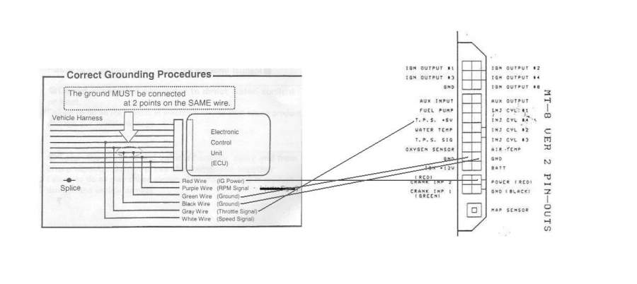

T talam_buruk Known Member Senior Member Thread starter Feb 7, 2004 181 2 3,018 Jan 25, 2010 #5 I got this fixed ..some error.. in my previous wiring.. here the update.. get replied from microtechefi forum..
