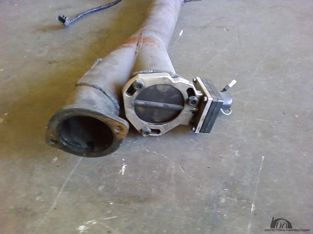

this thing can be put either in parallel to the existing exhaust or put in series..i put it in series. i too have a loud s-flow muffler hehe..but i think i am going to try the parallel installation after this..mine's is arospeed brand..rm 220 from kakimotor..it is the manual lever type..got 2 inch or 2.5 inch..enjoy!!

IMHO Better use mechanical type...
This is Apexi valve controller... AUD 190
Mechanical
I always spotted this at halfcut exhaust...
Hot exhaust fumes+motor electrically controlled = not a very good cocktail

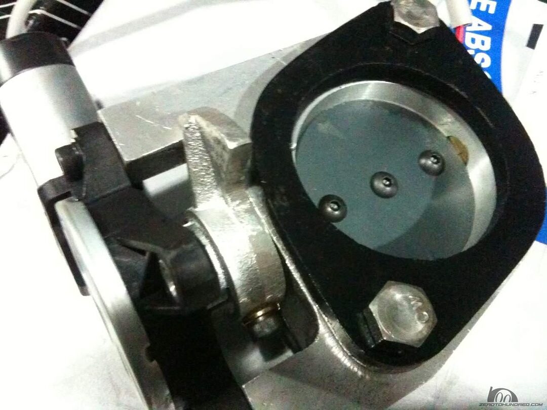

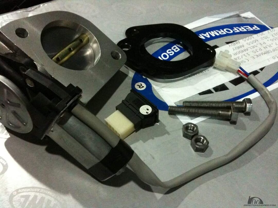

If you must, buy the mechanical one by Apexi. The electric one firstly needs wiring - its 5 inches long if that so you need to extend the wiring into your cabin to which it attaches to a Proton Saga mirror switch or something like that.
Will cost you RM580 and will fail after less than two days. Mine MELTED. I have pictures will post later. Receipt even to prove it was 2 days old but I don't want to ruin vendor reputation or anything.
It's not vendor's fault, its a design fault.
