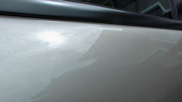

just after attended Christmas service & luncheon, I rush to rescue another disaster Merz, horrendously scratch by 2 cute poodle .....7 years old C class look great...but upon closer inspections
This owner actually came to see the CRV rescue mission 2 weeks ago, initially she says she send twice yearly to one of the renown Cars polish...and complete in 4 hours (while she shops) .....but hardly the any scratches removed...she said what so great about your
how many steps are u doing?....me....no steps...i just correct the defect paint till it shines again...alot of excuses just to slash $... I smile & says...i only do it for my passion...weekend, later she called me over to view her car & apoinment set
Now I had this opportunity to turn around for her, started around 2pm.... finished after 10pm

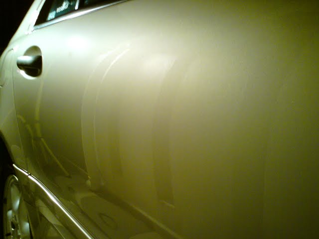

MISSION _ rescue badly scratches paint - when ecver she return to home, her poodles just welcome her by scratching all her doors...she even put them on her hood???????

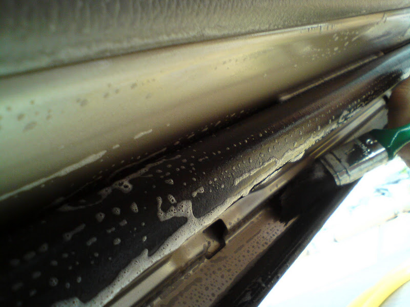

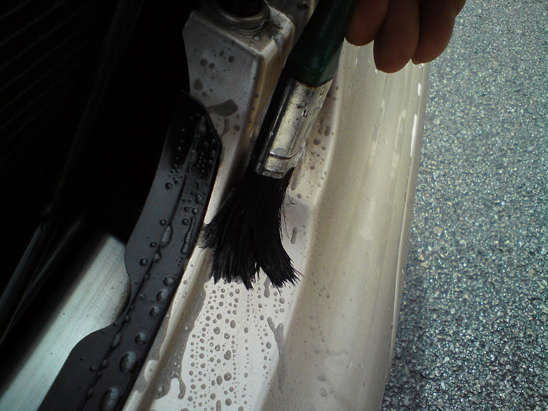

-Clean wheel & wash (2 bucket) -

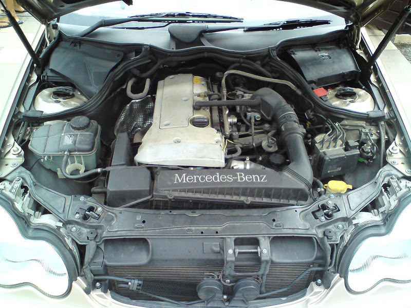

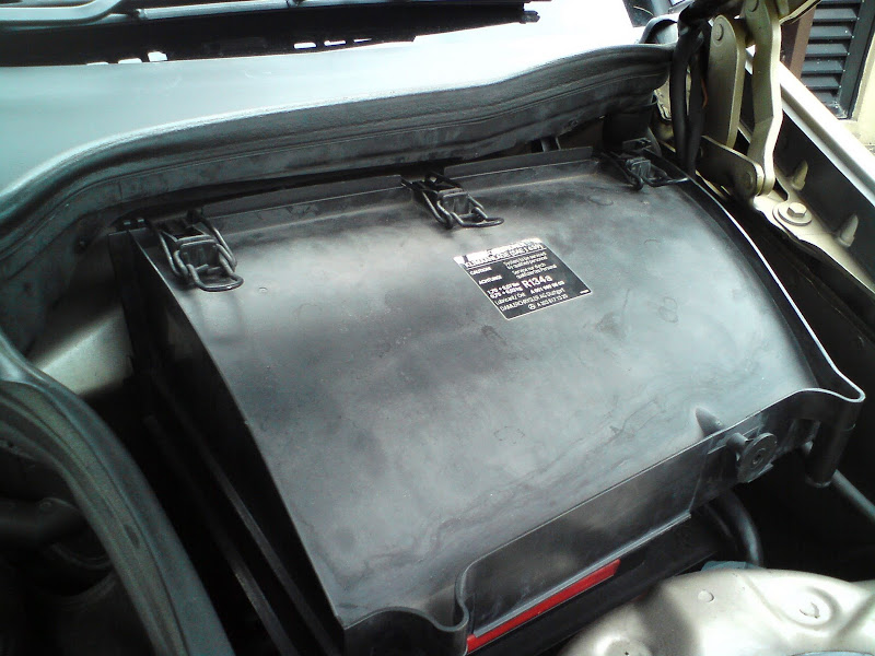

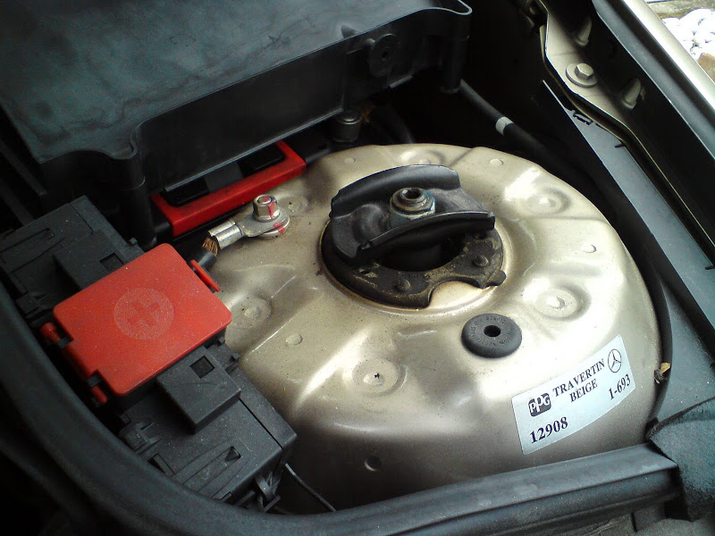

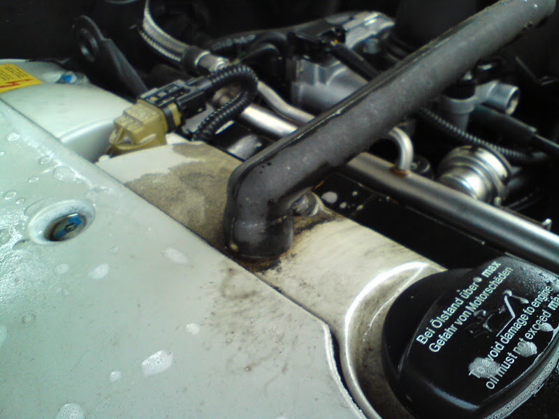

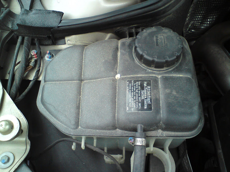

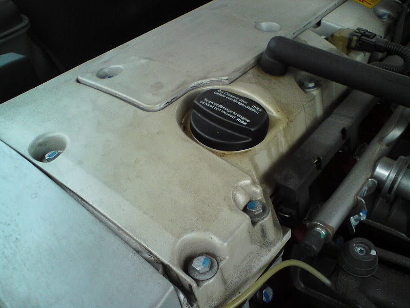

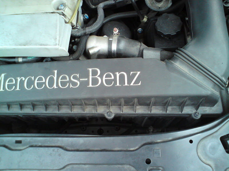

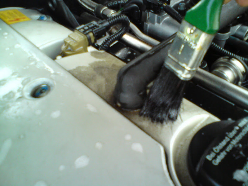

-Engine wash - APC (Dilution 1:10 water,with assorted brushes)

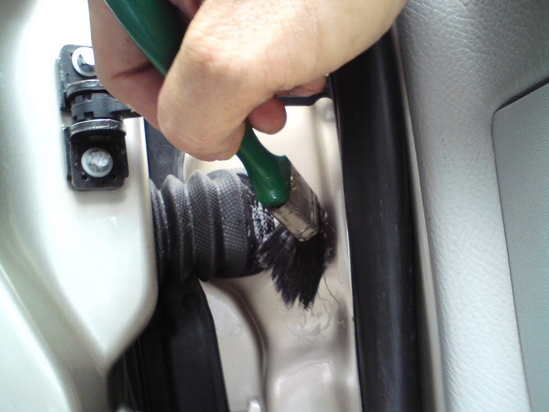

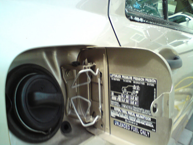

-Door & bonnet- side jams, APC (Dilution 1:10 water,with assorted brushes)

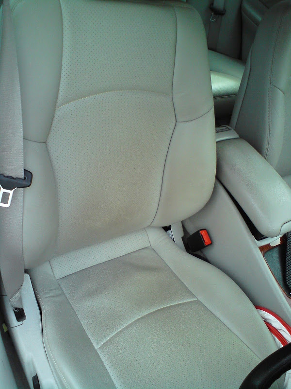

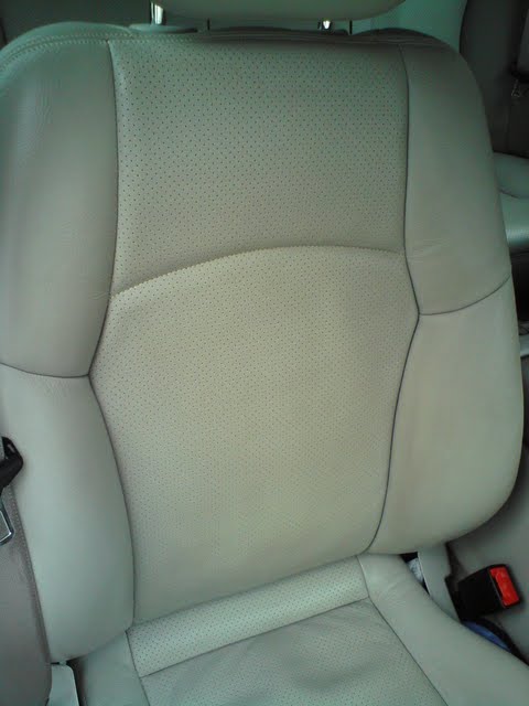

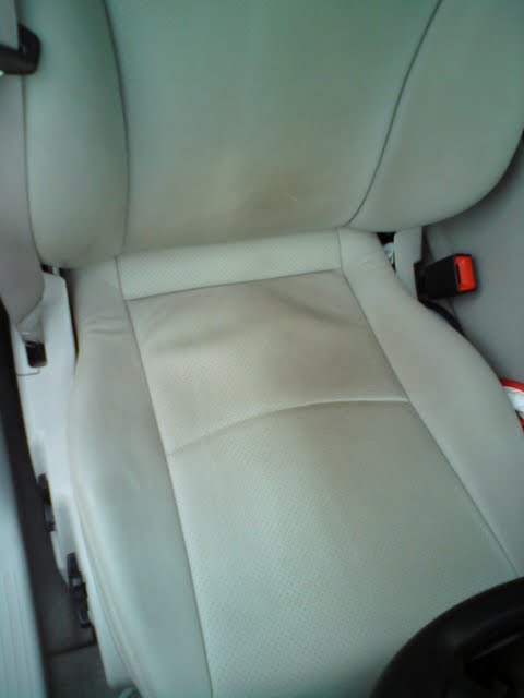

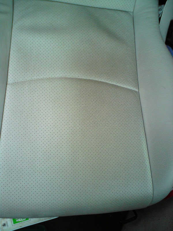

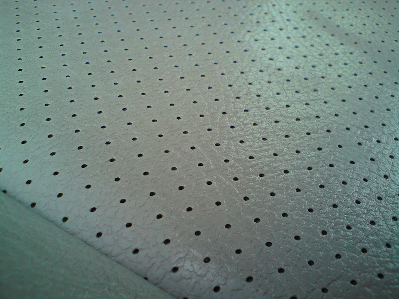

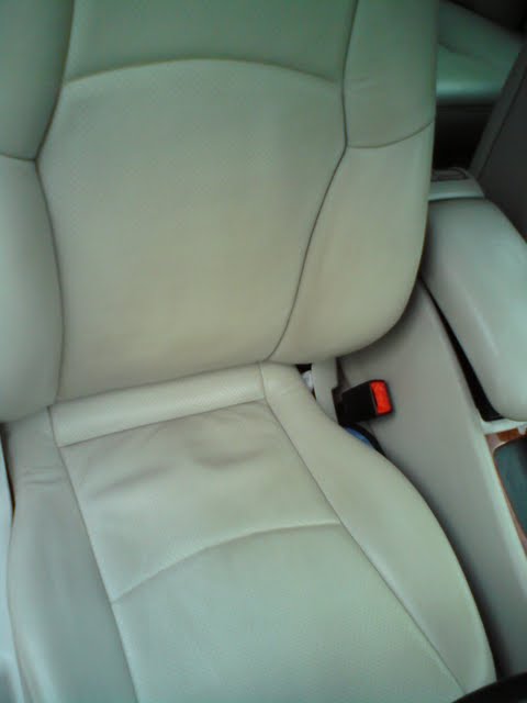

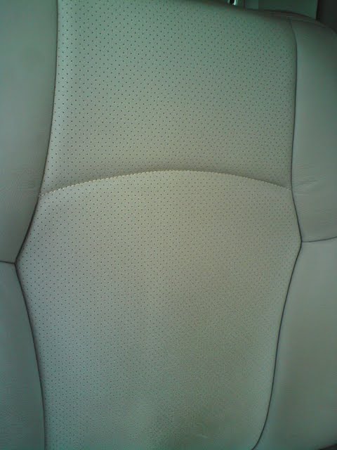

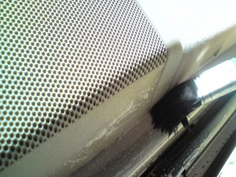

-Interior - APC + quick wipe down, seats - osren leather cleaner

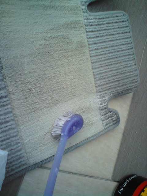

-Carpet - Autoglym Carpert cleaner with brushes

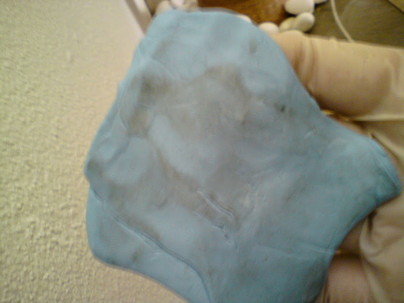

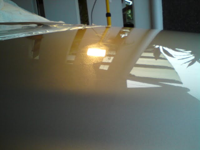

-BODY - Clay - mild clay, M105 with ccs cutting/R,ONR quick wash, followed by M80 CCs polish/R, NXT 2.0 & UQD

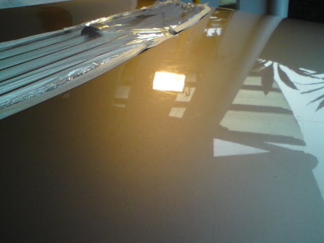

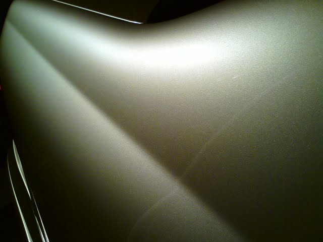

after...Aloe not applied yet
after

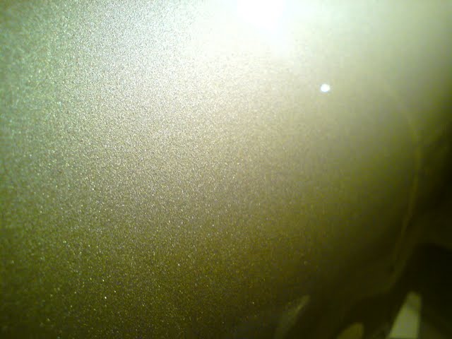

clay before

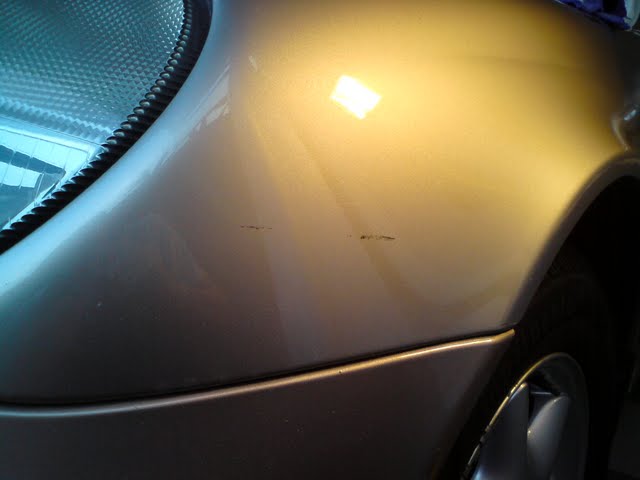

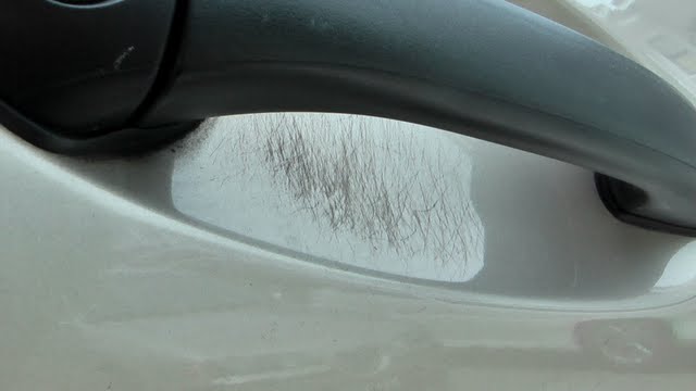

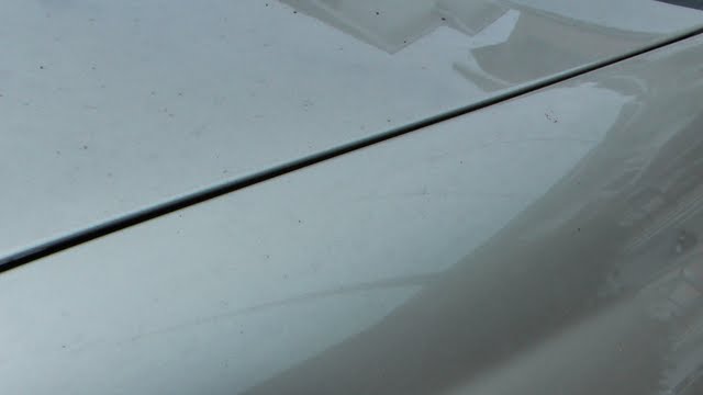

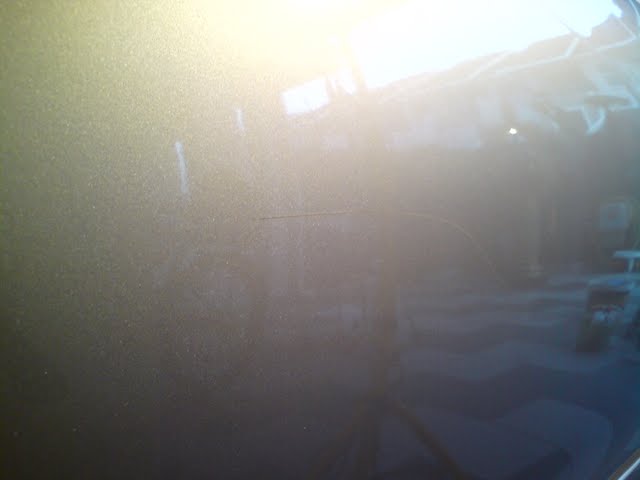

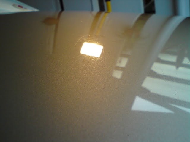

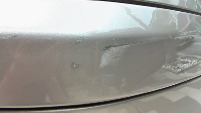

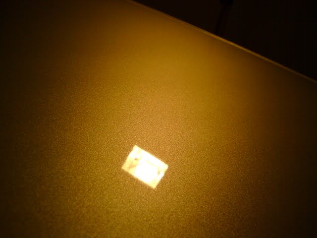

marks from her pet, poodle braking on the hood

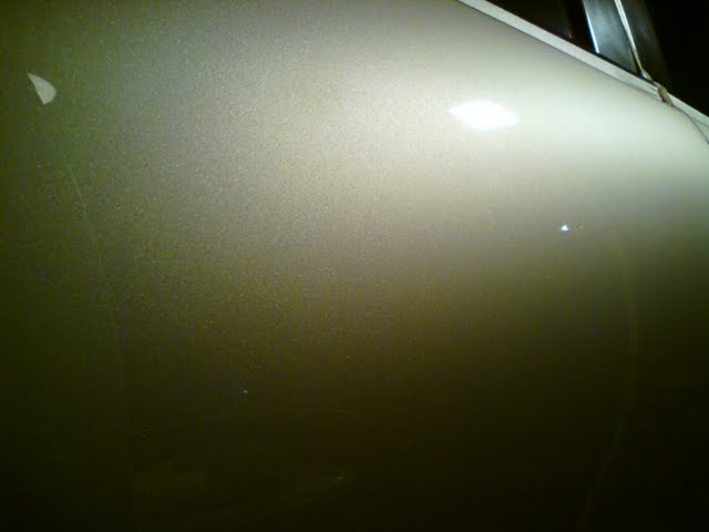

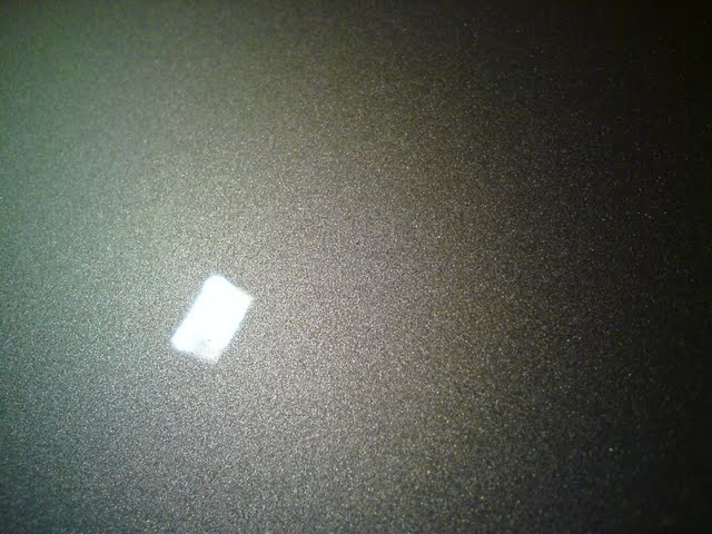

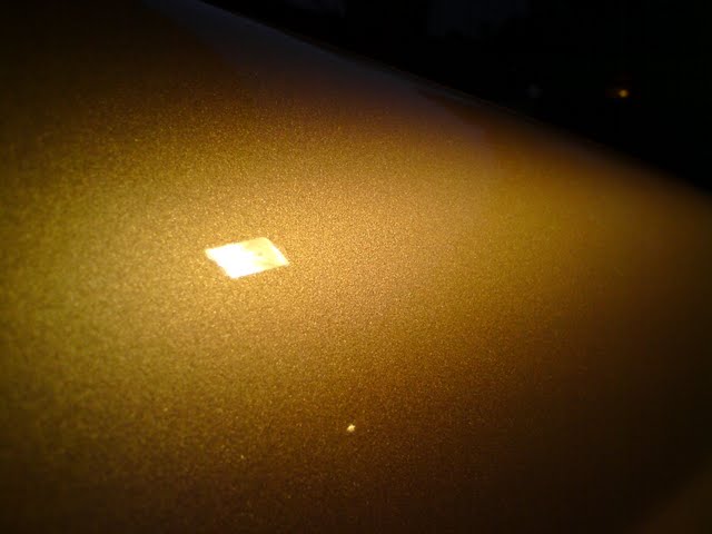

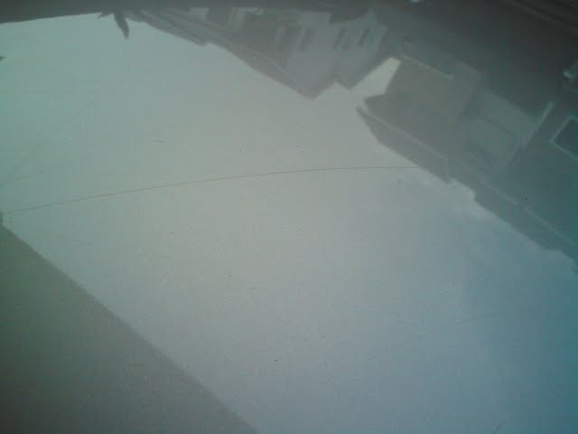

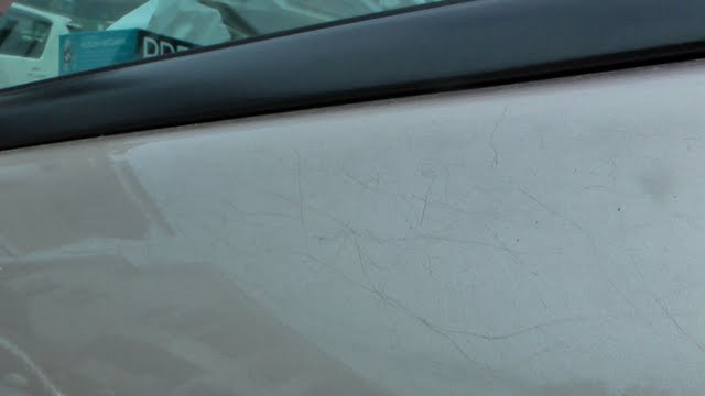

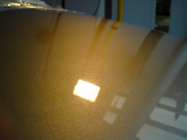

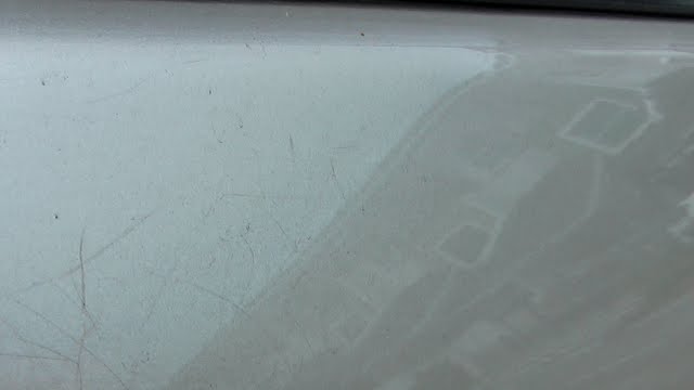

plenty of RIDS - random scratches, sorry - low res as all these pics was taken by my handphone,
often she put her 2 two poodle
more defects
more defects
picture more defects

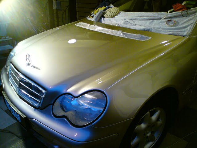

50/50 pics
area finish with 50/50 covering
50/50

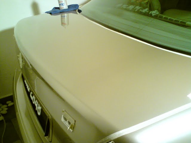

another 50/50
lots of scratchs
done
but not yet finish

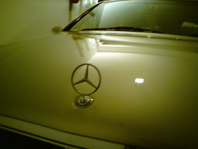

i just loves it clarity
after
after

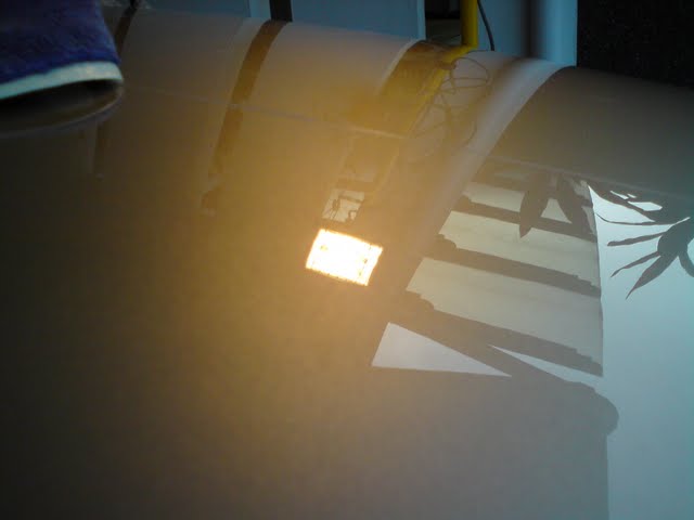

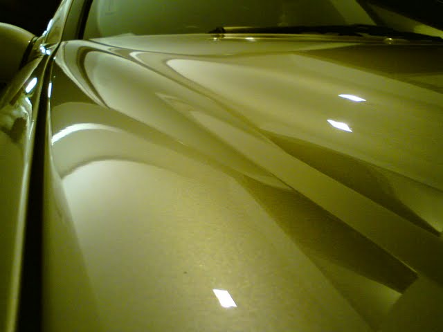

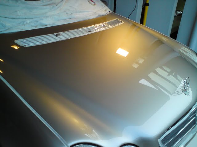

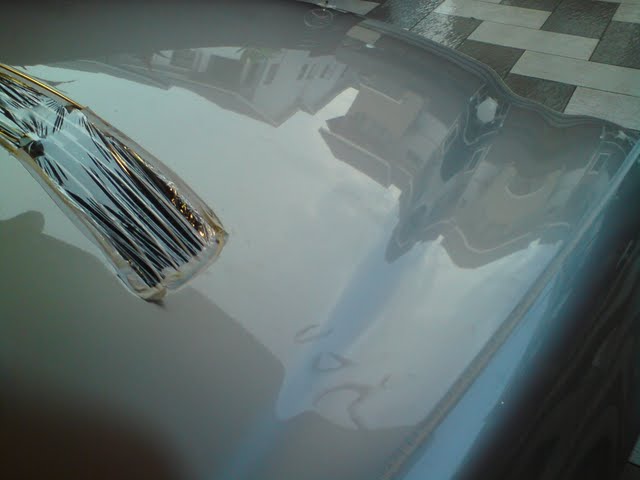

finishing pics

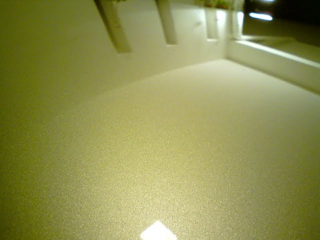

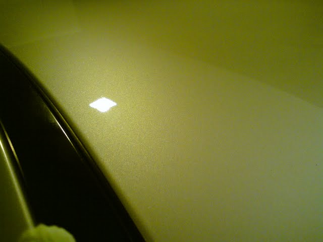

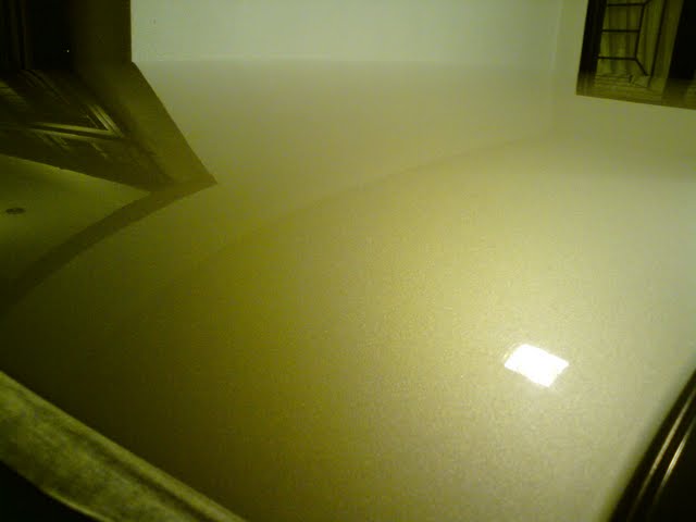

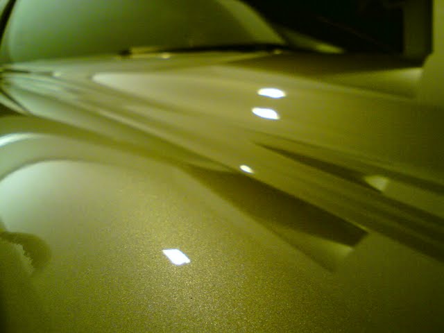

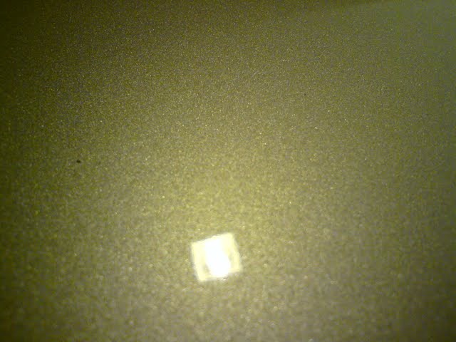

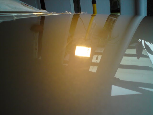

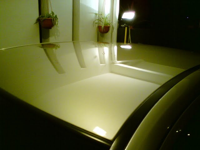

the depth & gloss restored ......clear & clean again
the depth &amp; gloss restored ......clear &amp; clean again<a onblur="try

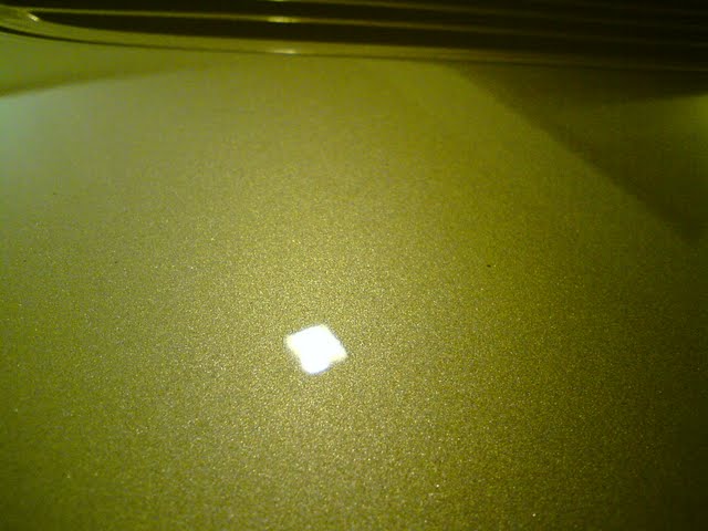

close up pics

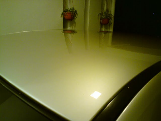

after all these detailing, this is the most enjoyable &amp; best ever i attempt

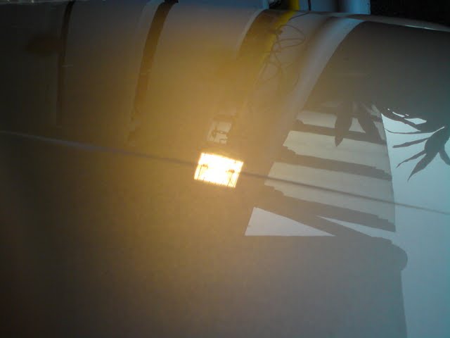

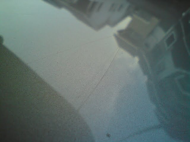

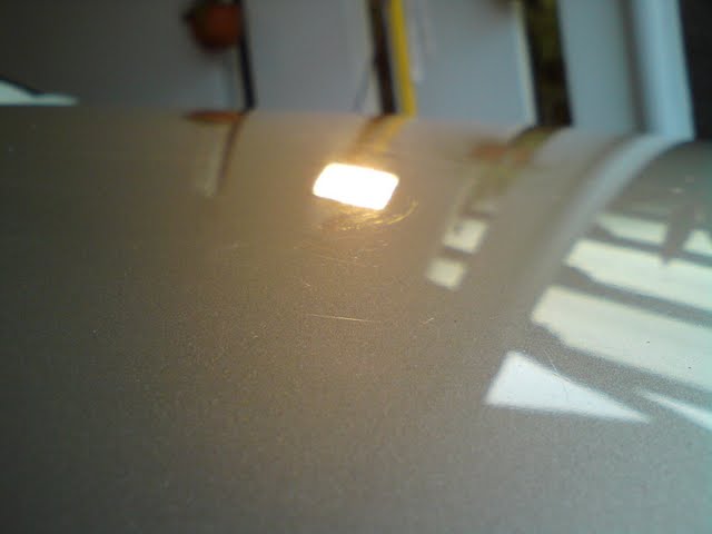

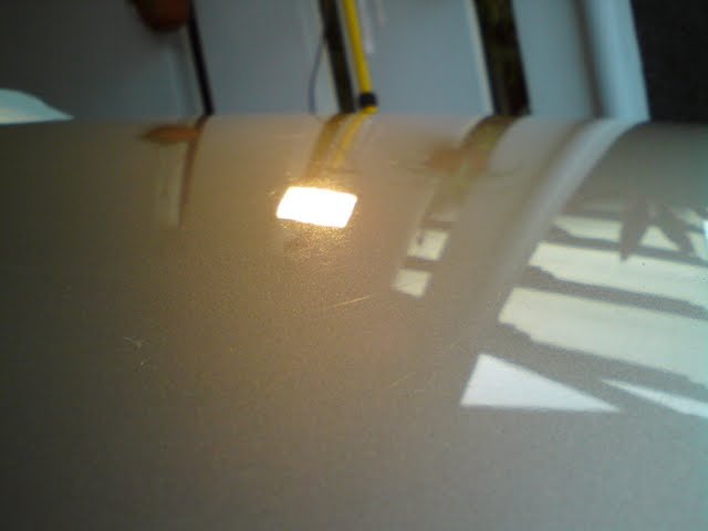

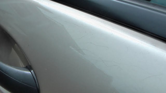

this was the pic before on the bonnet

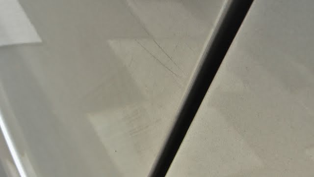

pics before....deep & long scratches ...dullness
rear bumper scratchs

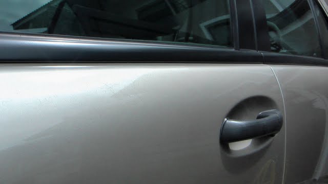

after

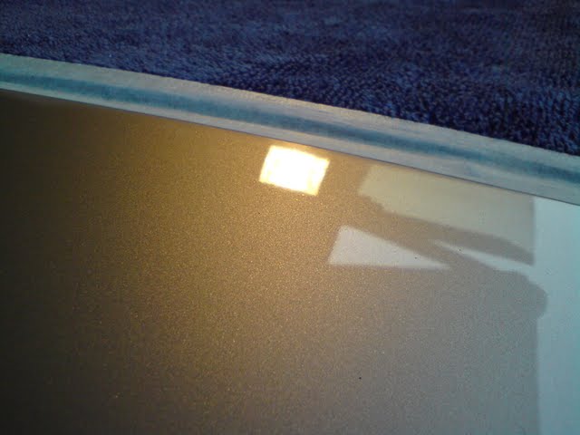

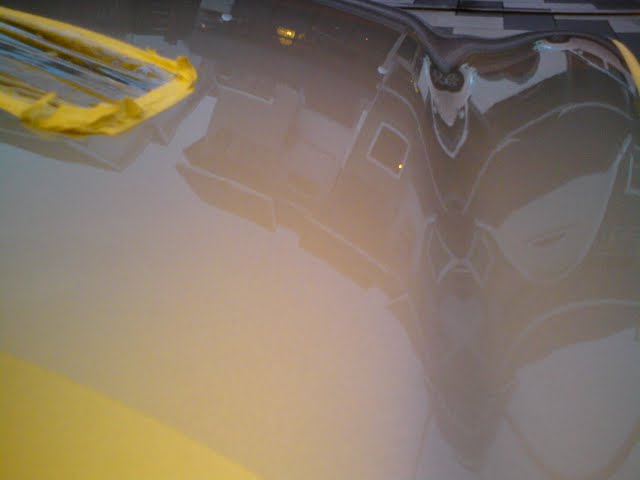

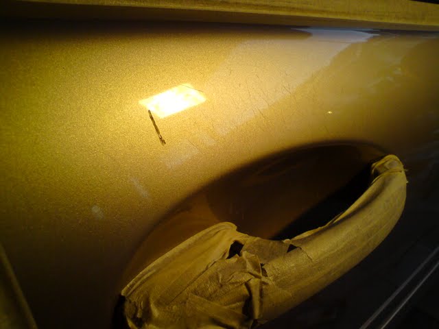

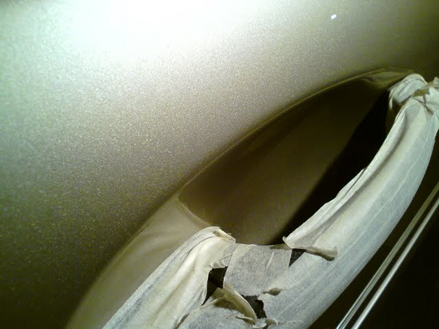

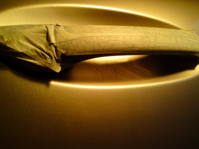

curious... must you tape the black plastics on the bonnet and door handle? (sorry noob question)
no need to be sorry
tapped to be careful not to burn the edge paint
very very careful when come to all edge with high speed rotary
