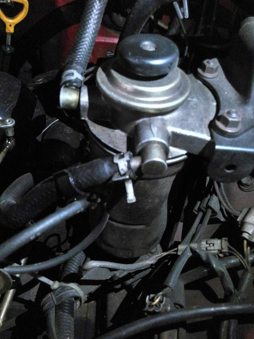

Evening all, I'm in Penang n was planning to return to kl this morning. The car cannot b started after many attempts. Found out that the diesel primer pump wasn't working n it's leaking. Worst of all, traveled the area by foot n ALL 3 workshops said they can't help me. Even Toyota service center Penang told me that they don't have the ability to help as it's an imported model.
Genuinely need help n pointers if anyone knows anyone/anywhere in Penang that I can contact? It's a Landcruiser 80 4.2 diesel '95 made. Thanks all!

UPDATE:
Happy Monkey Year all, here's an overdue update. First one of the primer pump's hose was cracked so got that replaced. Then the mechanic found out that the crankshaft pulley wasn't working, causing the radiator to NOT function. Couldn't find parts in Penang island so ended towing the car to Alor Setar where a family friend services trucks, came back to KL to get the spare parts then posted back to AS. Definitely an adventure along with CNY :burnout:
