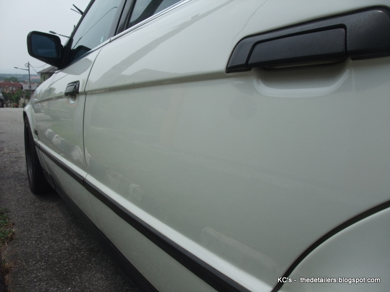

sun shots

so I decide to ANR my ride (alien no rinse wash) now in 20 minutes
How to ONR - soak in washing medium Opti mitt or MF
slowly glide from left to right ( wash begin from top of your car again) Sanitation
instantly dry with 2 MF
ta da
remember here
ANR wash it
ta da
before
after ANR it
ta da
just 20 minutes wash
another 5 minutes to top up my magnificent Protector (it also does help u to clean those parts of ANR maintenance wash missed) 2 in 1
the very next day
ta da
the key of maintenance is just my weekly wash & OID protecting it
