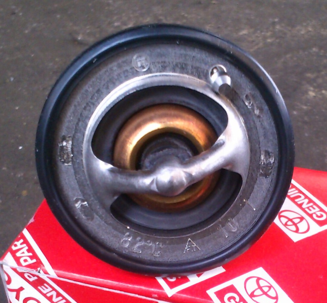

Funny, because the thermostat should control the temperature?:confused:
D7zul
2,000 RPM
D7zul
2,000 RPM
Feb 24, 2011
2,698
848
713
Shah Alam
yeah.. I was thinking d same thing..
maybe bcoz d thermostat have a lil hole n a loose plug in it.. around 2mm i think..
i asked d seller, what's that for? he said it's for air bubbles to go out..
that hole leaking xtra cool water inside my engine i think..
so, need to hotten d water a bit by setting d fan on auto on/off
D7zul
2,000 RPM
D7zul
2,000 RPM
Feb 24, 2011
2,698
848
713
Shah Alam
Bro, how much u bought this termostat?
Rm70 with d o-ring
---------- Post added at 08:11 PM ---------- 6 hour anti-bump limit - Previous post was at 08:10 PM ----------
It's new original Toyota genuine parts :wink:

bro...still keep the busted thermostat...can i borrow it...need to compare to some other model (lower temp) whether same or not...pm me
on the other note...buy external meter la bro or at least test with 1...lol...i got 1 spare just no adapter...
