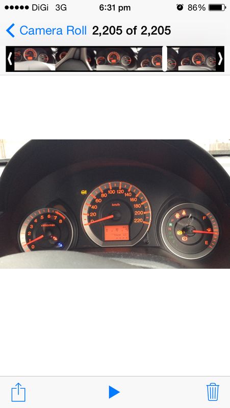

I need help. Recently my honda city 2009 dashboard warning light on very frequently. I sent to Honda service centre to checked. After several checking, they are sure that my car's ECU is ok, no error code appear. But it still happen again when i drive out from the service centre.
The warning light all on when in few situation :
- It happen when i gear in.
- It happen only when gear 1 & 2.
- It wont light on when after reached normal speed.
- It happen when i parking.
And when the warning light all on, i can feel the gear is a bit lagging. What happen actually ?
I attached herewith the photo & video of the said situation. I really need help on this problems. Anyone faced this problem before ? Any solution ???
Thanks in advance.

something like a friend had encountered. faulty TCU. it was dirty and in need of some cleaning.
btw, which SC did u go to? the SC which solved my mate's problem was HZN in glenmarie.
good luck.

Sound like something relate with the gearbox, maybe u need to check around how many sensor does the gearbox has.
Engine light on is mean the ecu did not received the correct signal from sensors.
It could be either sensor itself faulty or some of the mechanical parts caused sensor fail to deliver.
Bring the car back service center, fetch the technical support do the real time OBD.... should be able to detect.
