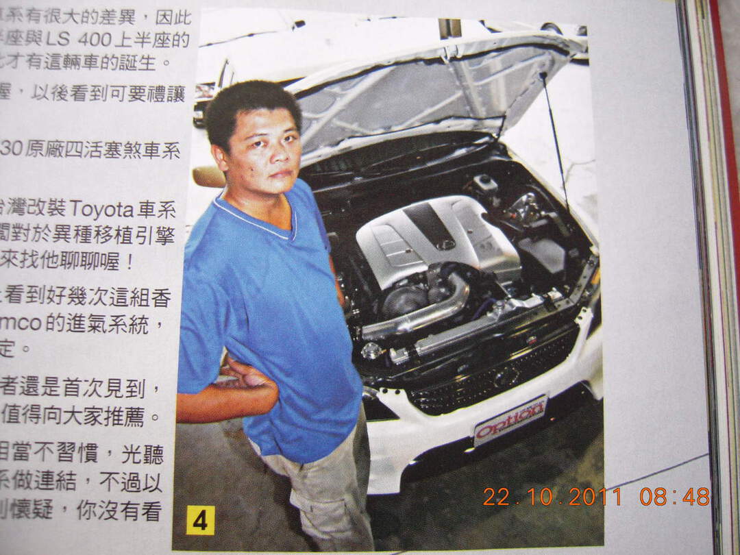

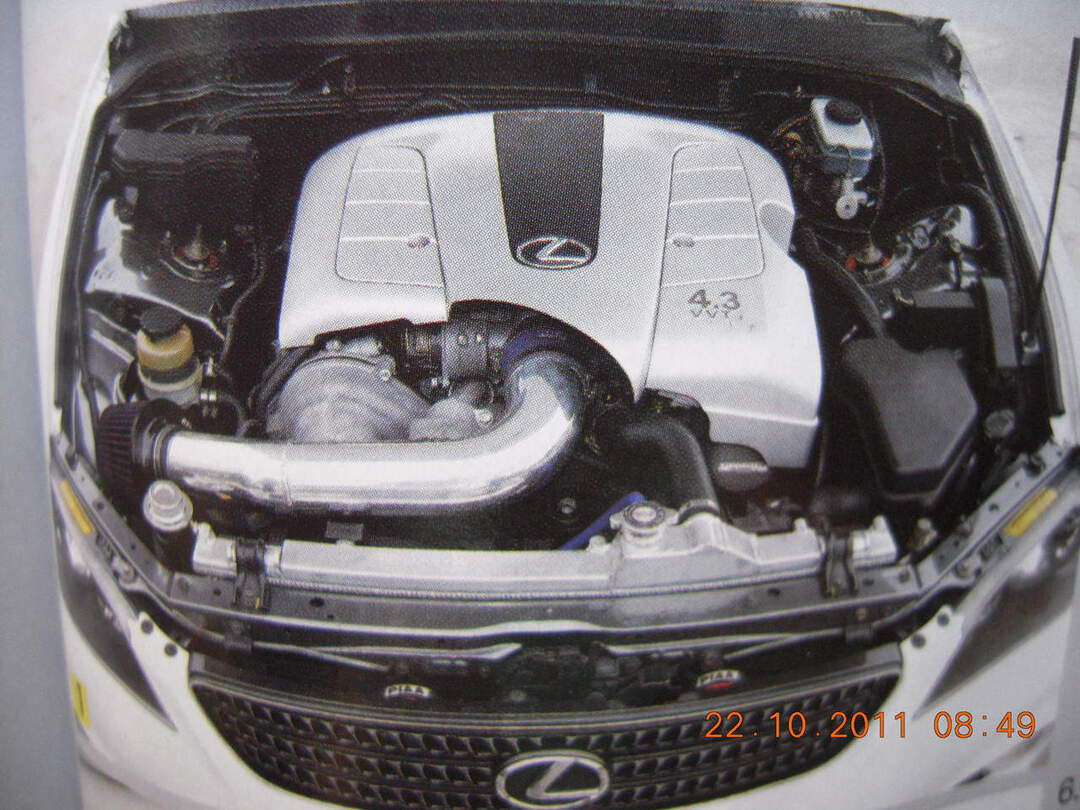

If I had listened to these nay-sayers I would never have done my 1JZ transplant and Altezza's would have been bullied by evo-protons;Type-Rs;scoobies and evo's
As for structural integrity the altezza was made for the american/european market in mind first and as owners will vouch its stronger than a BMW chassis.
This mod(3UZ) has already been done.

I'm more interested in the 3UZ from the SC430 because that autobox is native on the Altezza RS200 as well.
Miss this!! Less hassle to use gearbox from the half-cut(3UZ) The :banghead::banghead::banghead: is in the minor details that you dont first notice!!!
