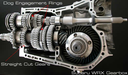

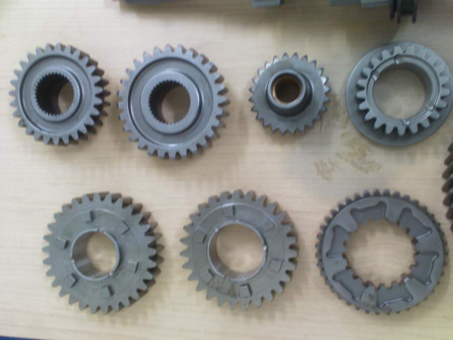

What does "dog" mean in "dog engagement gearbox" and "dog clutch"?
Sites that offer racing gearboxes use these terms as if they are household words with no explanation offered. What are some advantages/disadvantages of a dog engagement gearbox?
How much the Different between Dog engagment and Synchronizer engagment?

dog box. if you noticed the gears are all straight. our normal gears are slunt for smooth shiftings. they are straight like our reverse gear. hence the crunch and the wee wee sound like you reverse your car

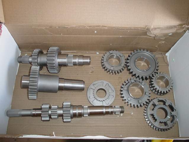

dog boxes contain custom straight cut gears which are cast differently and much stronger than factory gearboxes .. ppg in australia make good dog boxes .. they are commonly on race cars .. not easy to use like a factory g/box .. they wirr and crunch !!:)

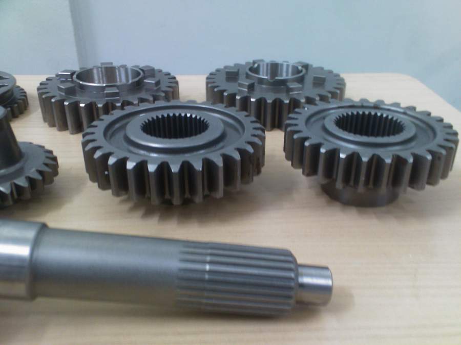

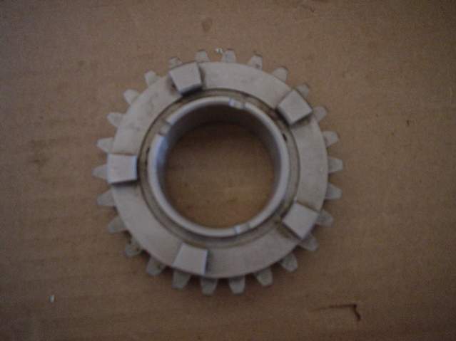

the gears being cut streight has nothing to do with dog engagement, if you look closely, synchro has a 1 to 1 lock up, meaning needs to be precise to lock up. dog engagement on the other hand does not. their teeth are like so far apart which makes it easier to lock up with a positive thrust/push.
don't mix up straight cut gears with dog engagement. they are different.

straight cut gears are stronger and can withstand higher torque n power from the engine... and it is louder compare to helical cut gears...
advantage of helical cut gears is dat they have quiet operation....

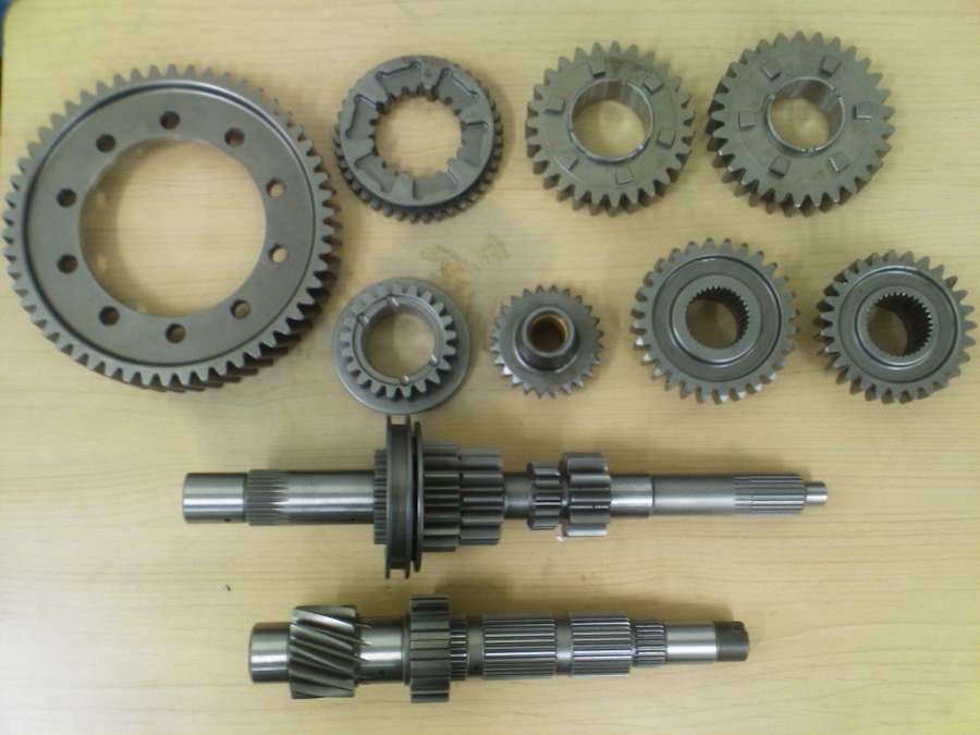

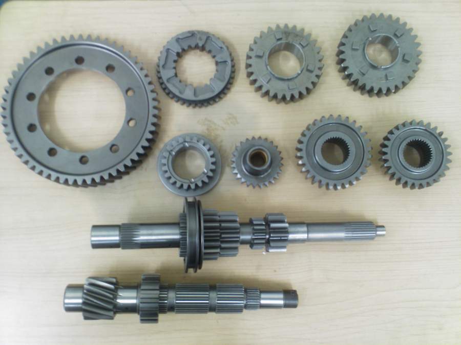

dog boxer dont use synchromesh as engagement. but it use simple bigger dog teeth for engagement. dogbox can come in spur gear (staright cut) assemble or helical cut gear. but of coz staright cut gear are much stronger than helical. millennium motorsports one of the dealer of the best dogboxs from ppg australia (ptizner performance gearbox). u can choose to buy or order customize dogbox for any car..
for any evo, skyline, s15 n some sports car they jave ready made that cost around 18k - 25k. u can also order the ultimate dogbox that come with sequential.
