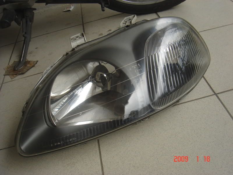

I did mine by melting it with boiling water, then prying it slowly. Be careful not to break any clips cos I did mine!make sure you reseal it properly and check for any leaking too!
here's my result hehe:
