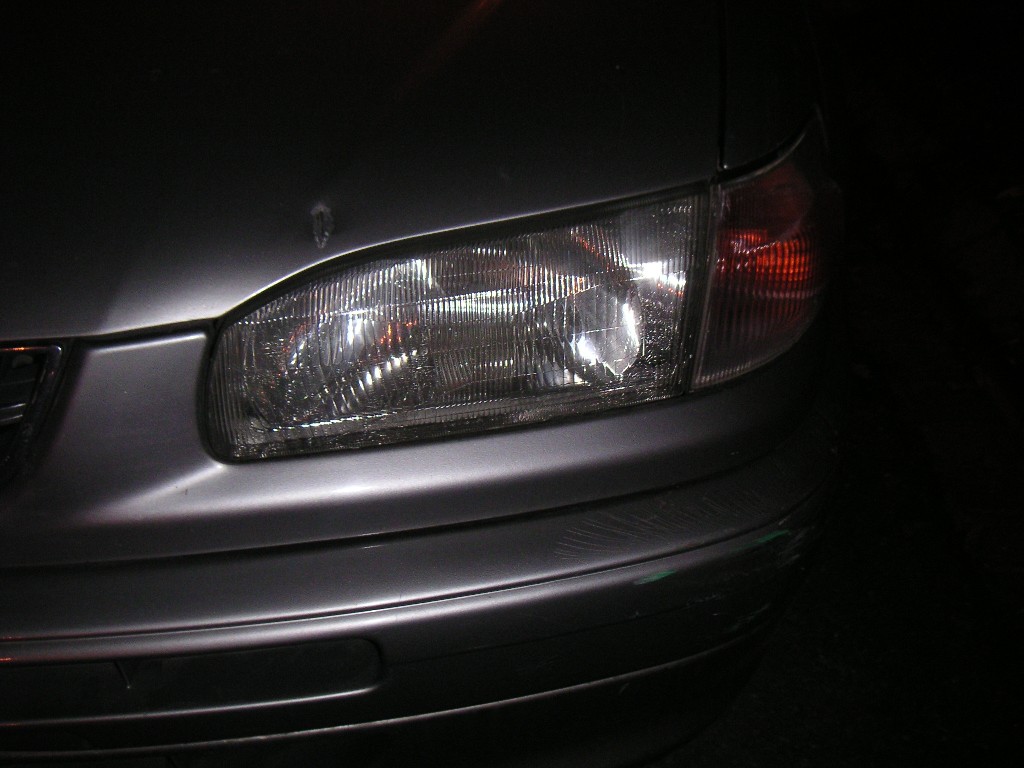

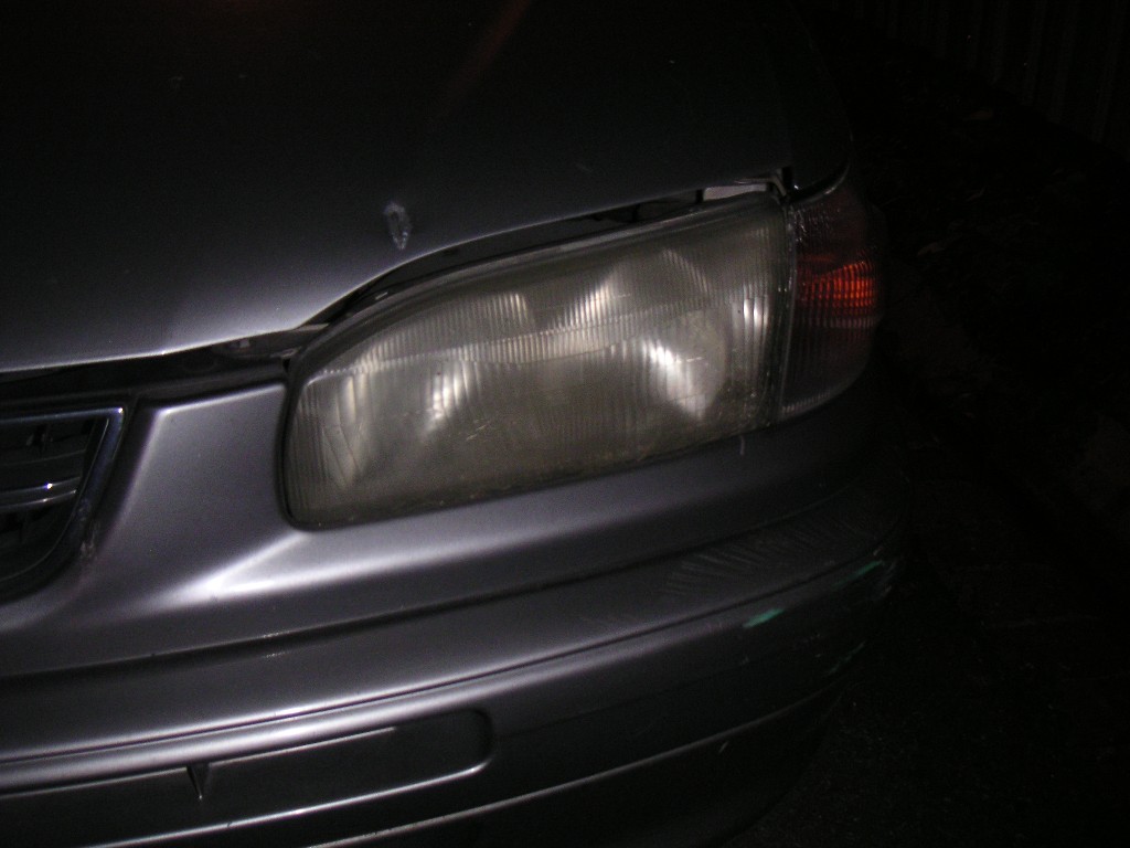

did similar thing like swift2510 had said
a very bad condition headlamp. always park out side from new. the plastic are badly oxidize.
this won't happen to cars with glass headlamps (waja, wira, old saga before lmst...)
glass headlamp will get stone chip. some will haze up, but from inside cause a layer of dirt form on the reflector.
worst oxidization are seen on kia sephia (the one with 4 round lamps)
clean the headlamp then wet sand with soap and 2000 grit. but i use cheap head lamp polish bought from supermarket.

remember to protect the surrounding panel with masking tape.
first try it on a small corner with the worse oxidation.
go easy on the sand paper. rinse with water and check from time to time.
if headlamp really badly oxidize till cannot see through and surface roughen like sand paper, you may start with 600 grit. you may skip sand paper altogether if not that serious.
after the polish, it will turn yellowish again gradually. just polish every 2 months or so, no need sand paper.
for the seg, some micro crack in the plastic are reveal after the polish. permanent damage, but not cause by the polishing process. nonetheless, certainly looks better after the polish.
