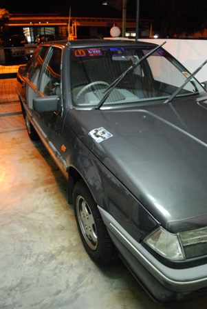

Hey ppl. I have an issue which got to do with my Iswara's body work. My car is almost 10years of age and the external shell of the car has been getting hell of a beating from the weather, bird shits & so on. Now, bubbles (small & big) are surfacing on the front engine bonnet & roof. Worst of all, the rust has eaten through the metal and now, holes!:bawling:. One miserable on the engine bonnet, one more on my car's roof:mad:.

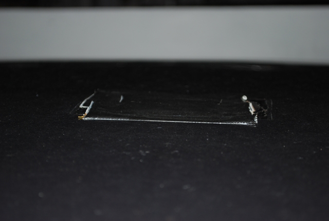

Temporarily, I'm using black water prove tape to cover the rusty holes. Won't last long of course. My mech said should replace with new metal cover, but it will cost me RM2500++ with painting. Well, thats alot. I've been reading and researching on alternatives. Patching up the damage is one option. Any shop in Penang which I could get it patched?. Thought of DIY, but the amount of tools & "kachang" needed, wow.
Do voice out your opinions & ideas as I want to keep my precious Iswara at it's best:proud:. Appreciate it!...

Pictures of the damaged cause by our Malaysian weather... lolx.
Bump: Well, not change car so soon lo. This Iswara of mine maybe gonna use another 5years. Save money first. hehex...
Bump:
For the front bonnet, i suggest u to change a new/recond set while the roof i dont think "patching" up would solve the issue because the rust will slowly "eat" the roof and body in the long run. u need to change/cut the whole roof.:viking::viking:
just my opinion
Agreed that patching it up will not solve it permanently. Well, if I do change the whole roof & bonnet, how much will it set me back?. I meant from half-cut shops.

Bro...Last time i have same problem about rusting on the roof...I juz go to the paint shop ask them if i juz put 1 layer of fiber on the roof den put anti-rust b4 painting.He said dat if do dis way can tahan about 4 to 5 months oni...But he suggest me if wanna do dis way,1st thing is move out the root n den wash n clear the rust n gum 1st den put new gum,fiber n anti-rust ....Therefore i try on dis way,as the result until now still nothing the bubbles cum out...Dis way save cost than change to the new 1...But its my 2 cents oni....:idea:

Not too bad of an idea. How long did that take & how much was it when you did it?.
My personal initial idea was to cut out the rusty part & get it cleaned. Replace with a custom cut out piece and weld it back with anti-rust, etc done accordingly. But have to get it painted if not the welded lining will get rusty. Then even more holy shit...

Serious?. Thought Proton is a national car & half-cut shops should have tonnes of goodies for it. Have quite a tight schedule. Must go search around Penang for workshop to inquire.
My current foreman is good. But he is making his stand on changing the whole roof & bonnet which could sum to RM1500++. Not the amount of money I wanna spend now on my car. Well, standard full body painting will be around RM1k estimated.
Bump: In the 1st place, how does the bubbles which leads to horrible holes on the body starts?. I know the weather and all. But what causes it to emerge?. What I have on my mind :
1.Bird shit(zzz). Didn't wash off and the acid sips into the paint?.
2.Bad paint work. Got micro air bubbles trapped between car body metal & paint layer?
3.Super miserable Malaysian weather. Damn hot sun then bloody long heavy rains. (HOT & COLD). So the metal expands & retracts causing microscopic gaps?.

I did it from end of last year,about the its depand on the painting shop.for me ady cost me about RM300 plus painting la...U not need to cut out the rust to replace it again....Juz going to ask some painting shop dat how to solve the rust problem on ur roof n bonnet....If u hv money den better change the new proton genius part not made in taiwan de....Erm,in dis 3 statement,no.2 n no.3 statement is possible will coz dis rusting n bubbles cum out problem....:biggrin:

Appreciate the assistance given ppl. I've decided to "Bondo" the rusted parts with added anti-rust for the holes. Bubbles le, sand paper it off. Don't care d. How to make my exterior nice?. Hehex. Will stick look-alike carbon fibre sticker. Tough shit i heard:smokin:. Can tahan our miserable weather... Changing the whole roof & bonnet is too much for me. But when I have the funds, will do so immediately. :biggrin:
Thanks again!!!...
