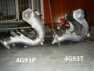

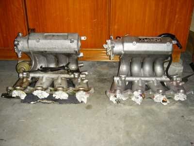

bro what damn is using gsr inlet manifold while deacon is using mivec 1..so any guys out there who have pic of both the manifolds to show all of us here wat's the actual diff between this 2 stuffs? any1 willing to contribute to this thread? ^^

Umm take a look at a 4G93P manifold it's the same as the Mivec manifold but the inside is different lah
