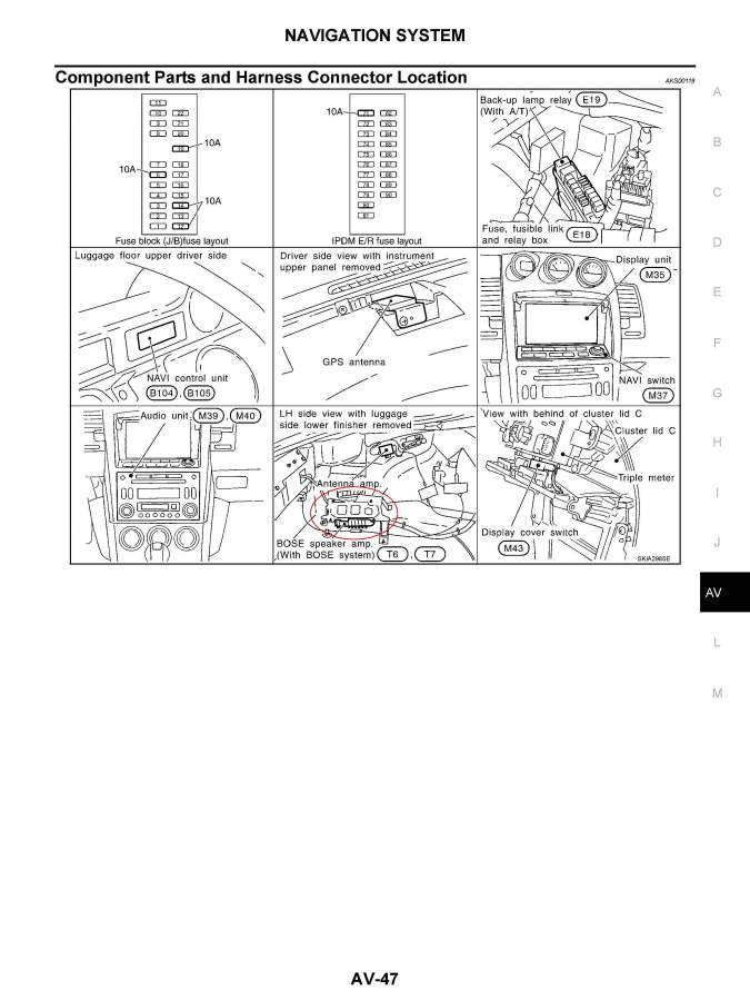

There is a small AMP in your rear boot for your Bose woofer and speakers (diagram attached). I not sure it actually work directly with the woofer or go throw Bose player. I have 94 pages AV diagram of 350z, it is very complicated and seems like the player connected to so many things. I guess the shop technician will not understand how the wires are connecting to each other and they will not spend time to investigate. Normally what the shop will do is to ignore whatever they don't understand and lay a new set of wire to connect to you speakers and woofer, of course, bypass stock AMP and other electronic instruments. They may ask you to get a new AMP as well.
