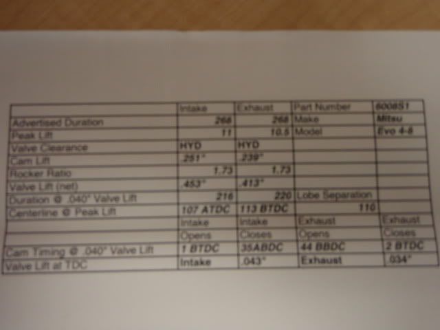

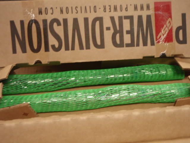

Bro here's the,
Specs:
Cams:

mmmm... older and new is that can be different thing ka.....
if old ,oldlah already, if new ,newlah already...
or the spec of the cams.....

Btw,do you know what is the different abt Older GSC S1 c:confused:ams compare to the latest GSC S1 cams?
Still looking for the used ones laa ... Told u it's not easy getting a S1 used. Becos most guys/gals will go for higher peak and boost when changing Cams ... so they go straight for S2 or HKS 272s etc ....
The new one u are referring to is the S-Series ... basically, the cams are built on newer technology available now compared with the 'old design' cams and information feedback they got when testing the 'older' cams. The new have their cams polished, smoother lope and higher lift and degree.
The 'older design' specifications:
GSC S1 Intake 268 10.5mm
GSC S1 Exhaust 266 10.5mm
Compared with the 'S-series" newer design (specs already given above in the thread) ...
This is the same for the S2 and so on. Hope it answers your question, James ... So actually Madiewaters is right when he say maybe the specs ..

YUMMY:biggrin::biggrin::biggrin:
