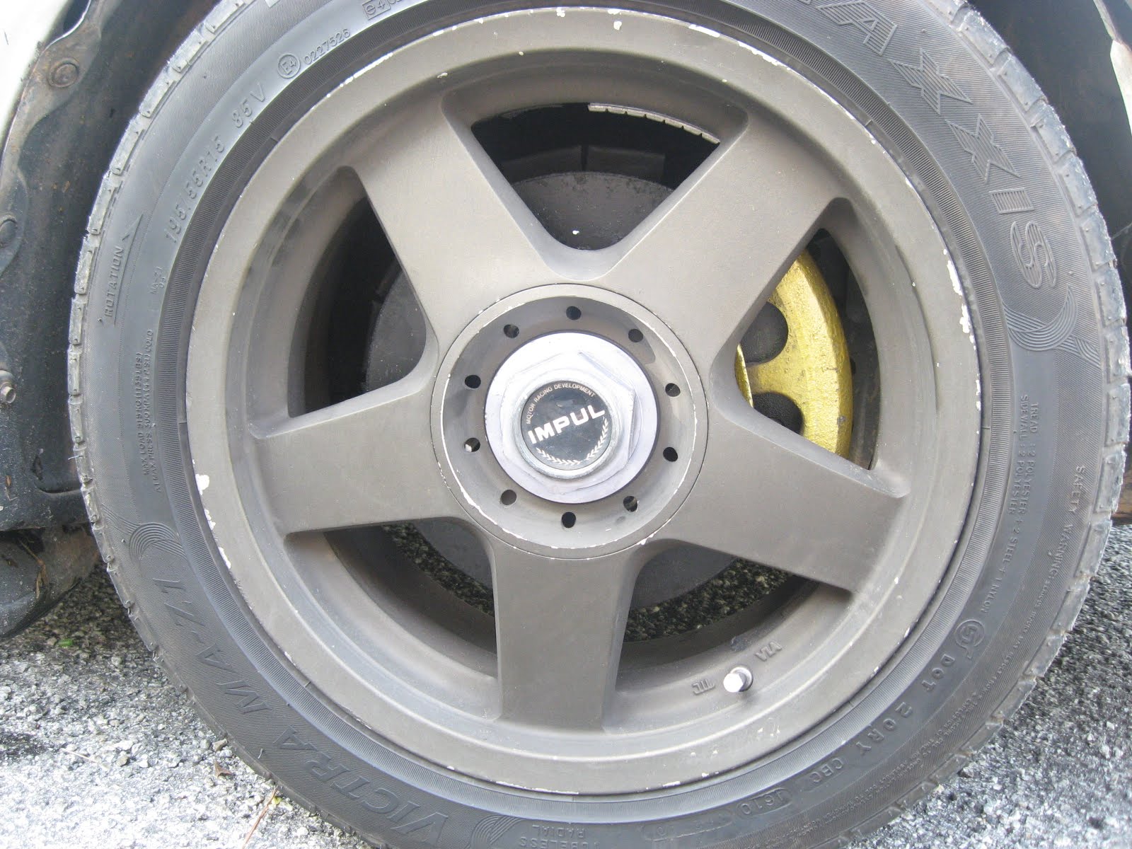

Comparison before and after
Put wheel and ready to go.
