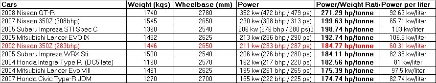

How heavy is a 350Z? Maybe power:weight not so good?

My latest finding shows that 350z power-weight ratio is NOT a problem. See table attached.
Data compiled from:
1. carfolio.com
2. fastestlaps.com
3. Wikipedia.com
